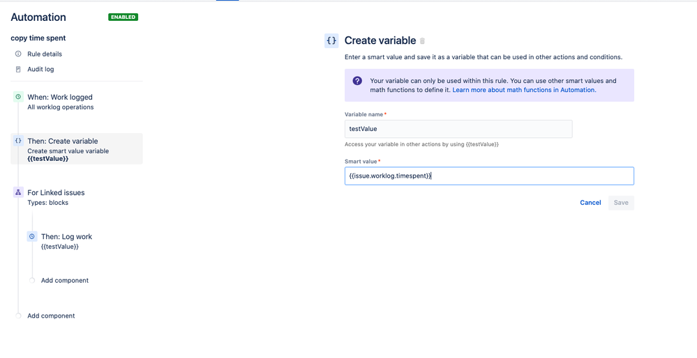

Using the work logged or field changed to trigger with the values for the work log, the entries for work logs are independently stored item are not tracked in Jira as a field change history item due to how the work log is stored as a specialized item apposed to a direct field value.
So to get the time log entered into the rule you need to create a variable to store the value you want to pass to the other issues.
This can be achieved with a global automation rule, and inputting a {{Create Variable}} action to store the work log item to be reused for the follow-up actions within the linked issues.  and you can use an automation rule like this:

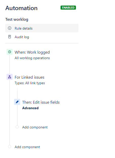

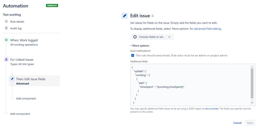

Hi @Otto Van Straaten
It is possible to set worklogs on an issue using automation, by using smart values and setting the JSON values in an issues 'Additional Fields' section (see https://support.atlassian.com/jira-software-cloud/docs/advanced-field-editing-json/#field-syntax-examples for some examples of this). However, I am not sure how this automation would work, as it is expecting a trigger from an event related to an issue. What event would you be expecting to fire off your rule?
Cheers
Sam
Otto Van Straaten
March 19, 2021
Hi @Sam Harding
Thank you for the advice.
I finally got it working using Edit issue fields.
