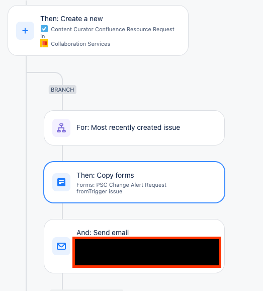

Hello,
Can we copy a completed Form, from one Request Type (1), to the Issue View of another Request Type (2), using Automation?  The Request Types are in two different projects.
I tried to use copy Form however, its not coping in the newly created request ticket, using Automation.
Where can I find the Automation for Jira, Issue View?  I noticed on the Request Type I want to copy Form from does have a Form attached.  I am not able to get it to copy using Automation.  See a portion of Automation rule below.
Thank you.

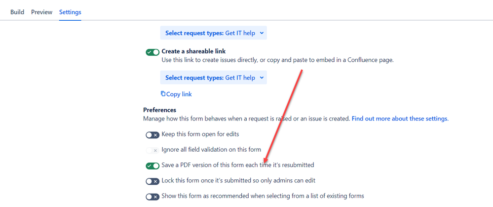

Have you consider when an issue is created utilizing the FORM setup that Save the Form as a PDF and attached to the issue.  Afterward, you can use automation to copy the attached Form to another project's issue as needed.
Here is the reference link - https://confluence.atlassian.com/jirakb/how-to-send-jsm-form-pdfs-as-an-email-attachment-to-specific-users-using-automation-1167830111.html
See image below on the Settings tab to enable the attachment function -
Hope this helps.
Best, Joseph Chung Yin
