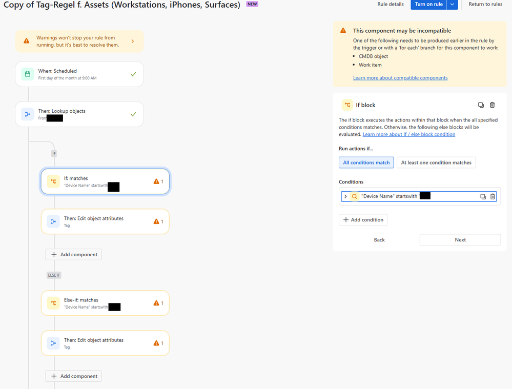

I want to modify a rule so that it does not always run when an asset is updated, but only once a month.
I then copied the original rule and added a schedule in front of it with a lookup function, but it doesn't work. How else should I use it?
It doesn't work without the lookup function either. I just thought the rule needed something to tell it where to look.
Lookup function, Query: objectType = "[NAME]"
Brief explanation of the rule:
The rule should always run on the first day of the month and check how the name of an asset begins. If it begins with “XYZ,” a tag should be added to the field; if the name begins with “ABC,” a different tag should be added.
NEW ONE with errors:

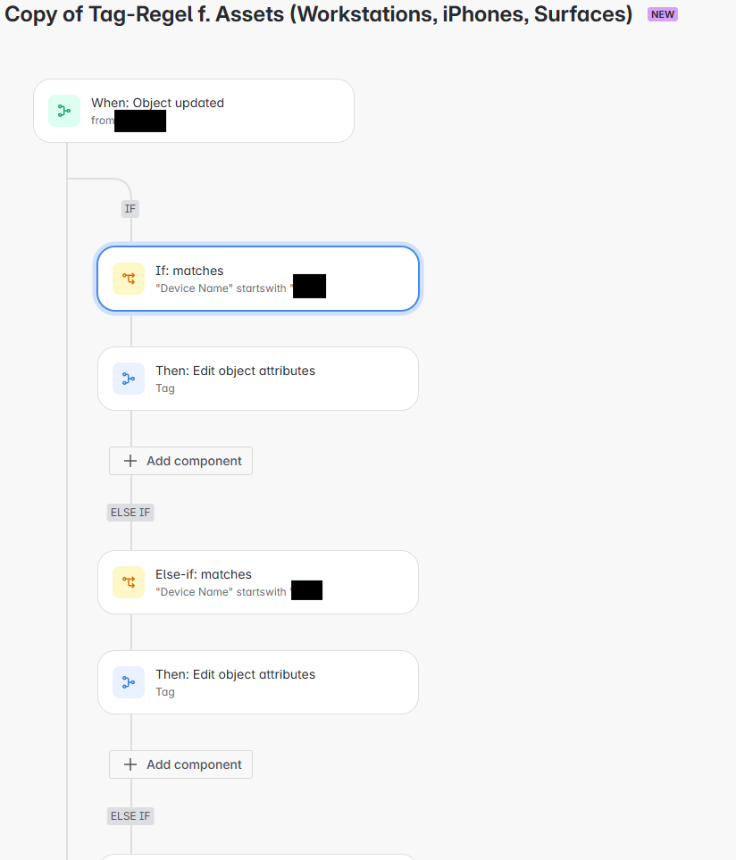

Old one, works:Screenshot 2025-08-14 152409.png

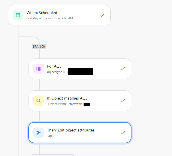

Antonia
September 4, 2025
I have done it like this and it works:

August 14, 2025
Hi @Antonia
When using as lookup you will need to branch based on the {{lookupObjects}} as you need to iterate over the found objects.
The initial rule acts on a change of a single object, by changing it to scheduled with a lookup it will find multiple objects and you will need to address each found object.
Antonia
August 14, 2025
Hi @Marc -Devoteam-
thanks for your reply.
So, under the lookup, I create a For AQL loop and then I have to put all the “If” and “Then” statements in the loop?
Or what exactly do I have to write in the lookup?

Marc -Devoteam-
August 14, 2025
Hi @Antonia
You needed to branch on the lookup and then use If/els conditions in the branch
No you can branch for AQL, as you have multiple objects found
Antonia
August 14, 2025
Hi @Marc -Devoteam-
Do you mean like this?
“For AQL” contains the name of the object type, which now looks for the entire type and then checks the conditions.
Bill Sheboy
August 14, 2025
Hi @Antonia
Yes, and...to the suggestion from @Marc -Devoteam-
The branch to the objects is needed...however, the if / else condition block cannot be used inside of a branch.
One possible workaround for your scenario is use a Lookup Table to perform the mapping of values to tags, then use the table get() function to check for a result, and when found, add the tag.
