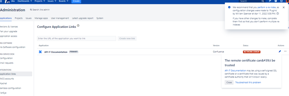

Hello we are not currently under a cloud environment. When checking the Applications > Application Links page the status is Network Error. We currently have jira.PNGlocally signed certificates installed on our server until our normal certs are applied.

No both Jira and Confluence are on-prem on the same server.  I found this article https://confluence.atlassian.com/kb/how-to-import-a-public-ssl-certificate-into-a-jvm-867025849.html suggesting to import the SSL into JVM but I don't have Java installed on the server to complete the process.  The certs for the two servers is in the trusted store on the server, I checked the URLs and their bindings in IIS everything looks ok.
