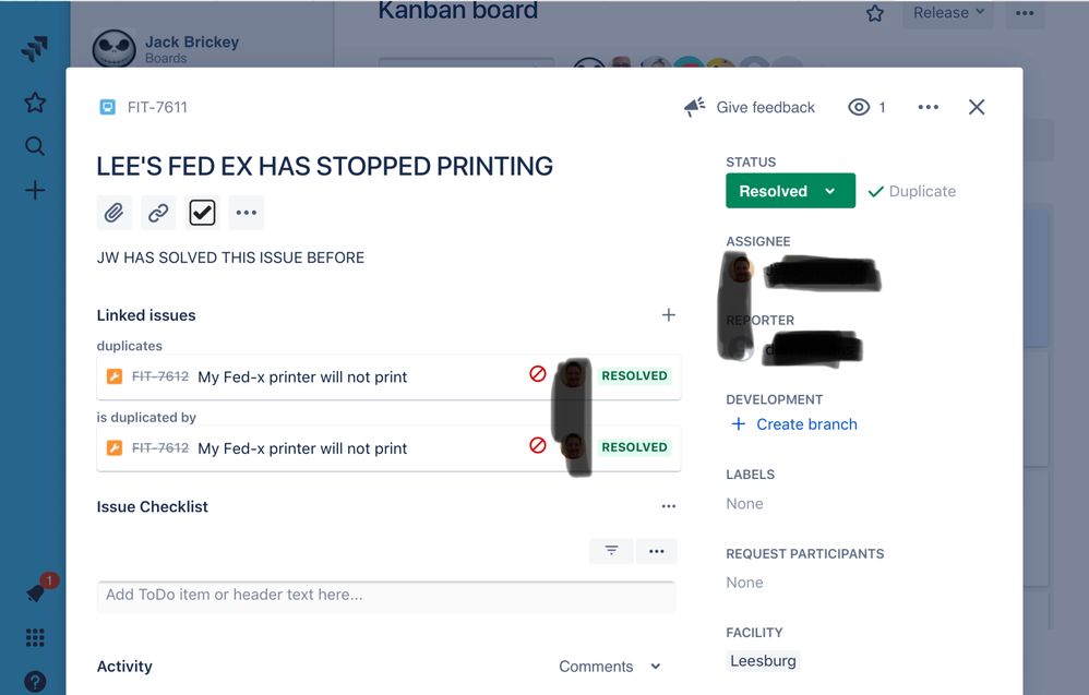

Can you share a screenshot of a Jira view you are trying to mimic in JSD?
below is a JSD project. This is seen when using Kanban boards which isn’t all that common with JSD but doable.

The new view appears when working with Kanban boards. Do you have a Kanban board set up for JSD project? If you are working in queues and click on an issue you get the detailed issue view not the new view.

sorry i'm not making myself clear. While I'm still learning the new jira issue view, my experience is that there are certain paths to viewing an issue that will produce the new jira issue view and others that will give you the detailed issue view. Even w/ Jira in the new UI if you search for an issue via the magnifying glass and then click the issue you will be taken to the detailed issue view NOT the new bento-box view. If you go to a project in Jira and click on "All issue" or similar sidebar link you will see the new issue view displayed but if you then click on the actual issue key in the new issue view you will be taken to the detailed issue view.
Now w/ JSD, the project view looks completely different and Queues replaces all other links to issues associated w/ the project. In Queues the issue view will take you to the detailed issue view. BUT, if you want the see the new issue view you could 'force' it to happen by creating a kanban board for your JSD project and from that board you will get the new jira issue view.
