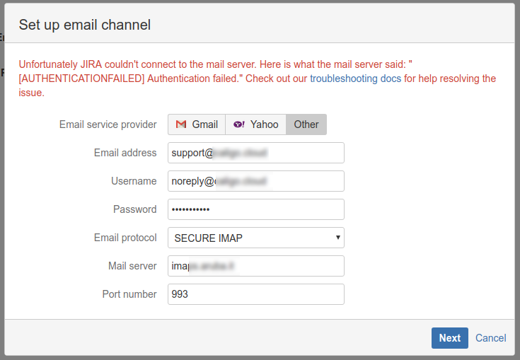

The last post explains, that this is possible by using aliases, so I could have one account, e.g. noreply@foo.com, retrieve all incoming mail and split by recipient, and when sending the "from" address will be accepted since it is an alias.
I have created such an email account with aliases, I can retrieve the mail correctly. I have configured the first project as follows (please disregard the authentication error):

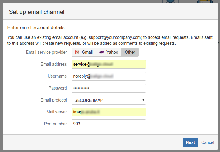

I configured the email request for the second project as shown here:

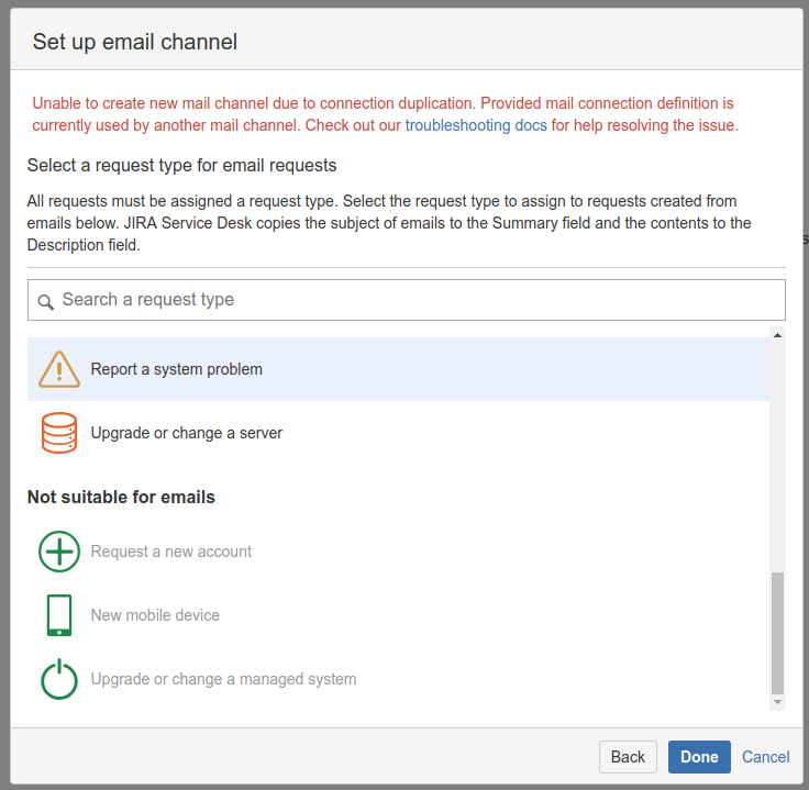

After selecting the request type I cannot continue:
Btw: the "troubleshooting docs" link goes to a dead end.
Searching online for "Unable to create new mail channel due to connection duplication. Provided mail connection definition is currently used by another mail channel." I found this page: https://confluence.atlassian.com/jirakb/unable-to-create-new-email-channel-due-to-connection-duplication-error-827338480.html
However, when performing the queries as indicated, I do have entries in the table AO_54307E_EMAILCHANNELSETTING, so I'd guess it isn't the same issue.

I found it!
I did not set Email requests, but configured two email handlers, one per project, with the "Catch Email Address" property set to the corresponding alias.
I also configured separate notification schemes, to allow for separate "from" addresses for the email responses.
Tested it, and it works fine.

However, that won't work, I tried exactly those steps:
I went to project Support -> Email requests and added the email account noreply@foo.com with alias support@foo.com .
I repeated the same steps for project Service with the email account noreply@foo.com with alias service@foo.com BUT the error message appeared.
