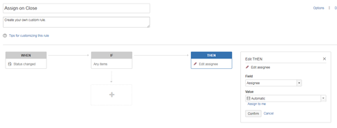

@Jack Brickey thank you for the help. I'm trying to assign the ticket to the Service Desk Agent performing the action.
This is the rule:

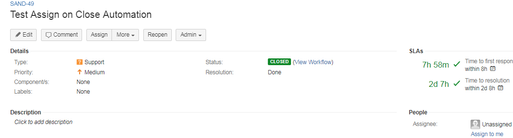

In testing, the logs show the rule having run successfully:

the "automatic" in the value does not resolve to the person editing that would be "currentuser" unfortunately it appears that "currentuser" is not an option w/in the "Then" actions.
Have you looked at implementing via the workflow as a post function? For any transition add a post function to assigne to current user. Now I realize that this will not meet one of your requirements "if the issue is unassigned". But likely Unassigned normally would only exist in the initial status so adding just to the one status might be ok?
otherwise the only thing i can think to suggest is a plugin e.g. Scriptrunner and there are others but if you are on Cloud it is limited.
