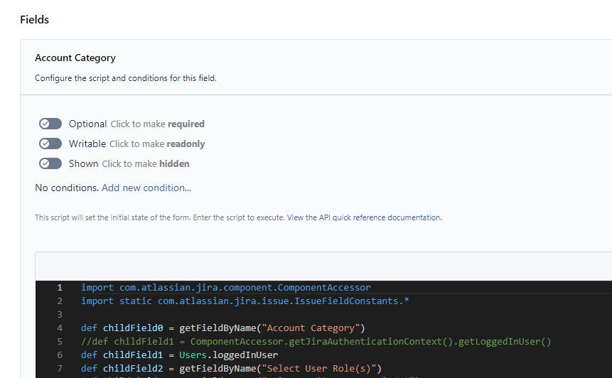

Does not work unfortunately. Here is the code being used:
import com.atlassian.jira.component.ComponentAccessor
import static com.atlassian.jira.issue.IssueFieldConstants.*
def childField0 = getFieldByName("Account Category")
//def childField1 = ComponentAccessor.getJiraAuthenticationContext().getLoggedInUser()
def childField1 = Users.loggedInUser
def childField2 = getFieldByName("Select User Role(s)")
def childField3 = getFieldByName("Select ABC User Role(s)")
def childField4 = getFieldByName("Select ABC Notifier Group(s)")
def childField5 = getFieldByName("XYZ Organizations")
def childField6 = getFieldByName("Reporter").getValue() as String
def childField7 = getFieldByName("Organization")
def desc = getFieldById("summary")
childField2.setHidden(true)
childField3.setHidden(true)
childField4.setHidden(true)
childField5.setHidden(true)
def parentField = getFieldById(getFieldChanged())
def selectedOption = parentField.getValue() as String
if ((selectedOption == "OPT A")||(selectedOption == "OPT B") )
desc.setFormValue(childField1)
//if (ComponentAccessor.getGroupManager().getGroupsForUser(childField1)?.find { it.name == "ABC" })
if (childField1.isMemberOfGroup("ABC"))
childField3.setHidden(false)
childField4.setHidden(false)
childField2.setRequired(false)
childField3.setRequired(true)
childField4.setRequired(false)
childField5.setRequired(false)
//else if (ComponentAccessor.getGroupManager().getGroupsForUser(childField1)?.find { it.name == "XYZ" })
else if (childField1.isMemberOfGroup("XYZ"))
childField2.setHidden(false)
childField5.setHidden(false)
childField2.setRequired(true)
childField3.setRequired(false)
childField5.setRequired(true)
else

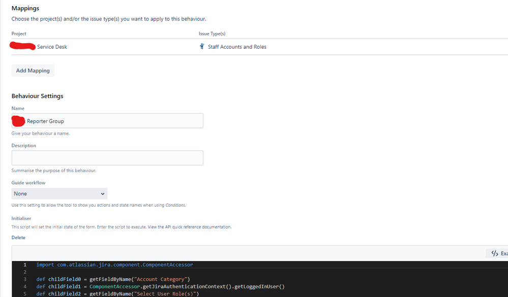

From the code you have provided, it appears you are using the Behaviour. Please share a screenshot of your Behaviour configuration so I can get a clearer picture and provide a better solution.

Marc Jason Mutuc
June 3, 2024
Please note that the script is working. Tested it for both JSM and Jira Software. However, for JSM, it only works for users that are not part of an Organization.

I have reviewed your code against the screenshots that you have shared, my first question is which field is this line of code supposed to represent:-
From the screenshot you shared, it appears that the Server-Side Behaviour has been configured for the Account Category field and you have declared a field called

Below is a screenshot of the Server-Side Behaviour configuration for your reference:-
If you observe the screenshot above, the Behaviour is configured for 2 projects, i.e. MOCK which is a Jira Software Project and ST which is a JSM project.

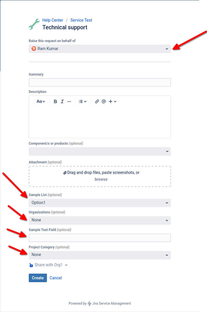

In your tests for the Portal (JSM), did you add the logged in user to a specific JSM Organization?
I used the provided code and it is still the same. Works internally, but on JSM it only works when the logged in user is not part of any Organization.
Ram Kumar Aravindakshan _Adaptavist_
June 5, 2024
Hi @Marc Jason Mutuc
Yes, I added it to a JSM Organization.
Please confirm, if the User you are testing with only belongs to an Organization and not to any Group.
Thank you and Kind regards,
Ram

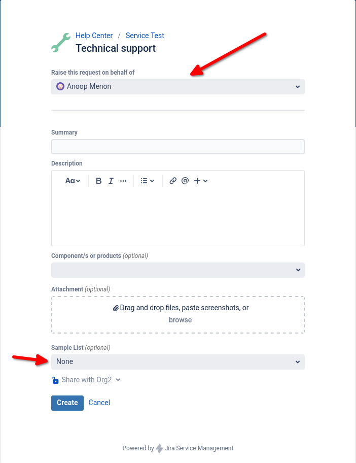

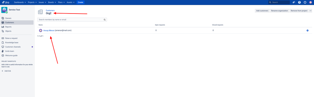

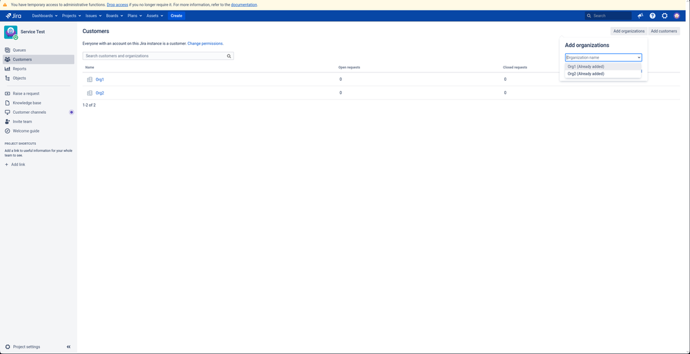

1. I have created 2 organizations Org1 and Org2 as shown in the screenshot below:-

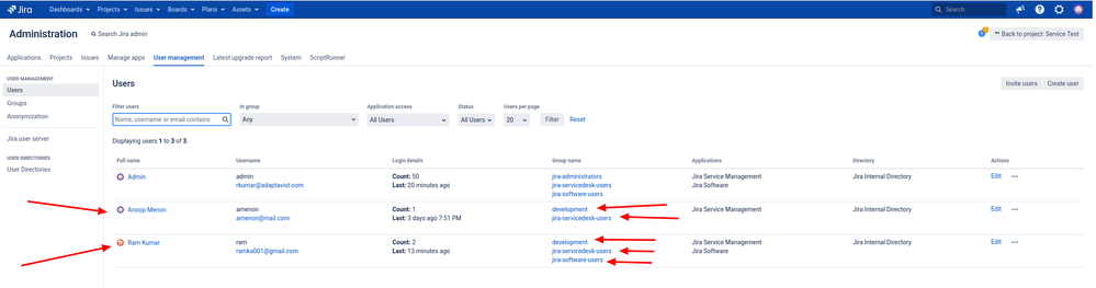

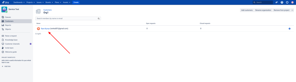

2. In each of the organizations, I added one user who is also a member of a Group.
For Org1, I added the user Ram Kumar, who is a member of the jira-software-users, jira-servicedesk-users and development group as shown in the screenshot below:-
For Org2, I added the user Anoop Memon, who is a member of the jira-servicedesk-users and development group as shown in the screenshot below:-
Below is a screenshot of the users according to their groups:-

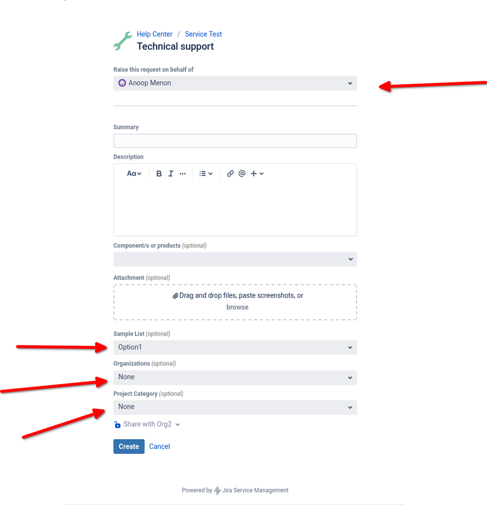

I made some adjustments to the code to include the development group and added a few more conditions to the if /else statement. Below is the updated code for your reference:-
import com.adaptavist.hapi.jira.groups.Groups
import com.adaptavist.hapi.jira.users.Users
import com.onresolve.jira.groovy.user.FieldBehaviours
import groovy.transform.BaseScript
@BaseScript FieldBehaviours behaviours
def sampleList = getFieldById(fieldChanged)
def sampleListValue = sampleList.value.toString()
def sampleTextField = getFieldByName('Sample Text Field')
def orgnanizations = getFieldByName('Organizations')
def projectCategory = getFieldByName('Project Category')
def loggedInUser = Users.loggedInUser
def adminGroup = Groups.getByName('jira-administrators')
def jiraSoftwareGroup = Groups.getByName('jira-software-users')
def jsmGroup = Groups.getByName('jira-servicedesk-users')
def devGroup = Groups.getByName('development')
sampleTextField.hidden = true
orgnanizations.hidden = true
projectCategory.hidden = true
def adminGroupMember = loggedInUser.isMemberOfGroup(adminGroup)
def jsmGroupMember = loggedInUser.isMemberOfGroup(jsmGroup)
def jiraSoftwareMember = loggedInUser.isMemberOfGroup(jiraSoftwareGroup)
def devMember = loggedInUser.isMemberOfGroup(devGroup)
if (sampleListValue in ['Option1','Option2']) {

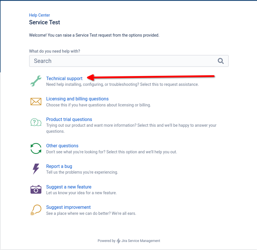

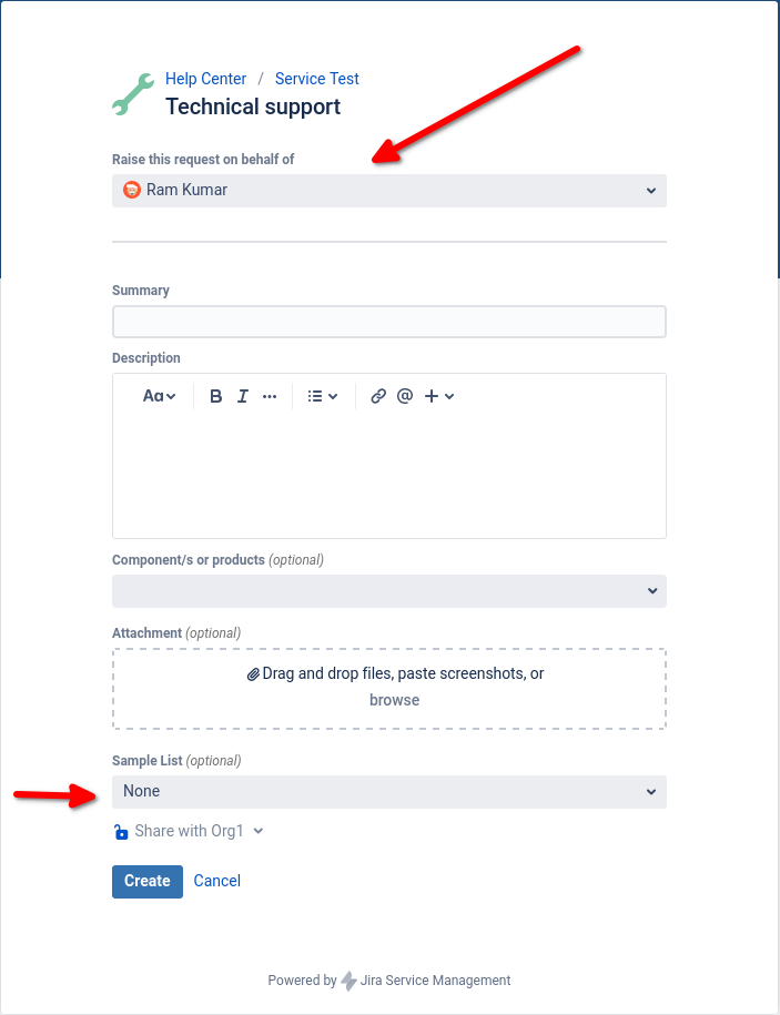

Below are some test screenshots for your reference:-
1. Firstly, I have logged it as the user Ram Kumar into the Jira instance, accessed the Service Desk and Raised the Technical Support request as shown in the screenshots below:-
As shown in the screenshot above, when the Create page first loads and no option is selected from the Sample List, as expected, the fields are hidden.
2. Next, when I either select Option1 or Option2, as expected, since this user is all 3 groups, all the fields are visible as shown in the screenshot below:-
3. Next, I log out and login as the user Anoop Menon, who is only part of the jira-servicedesk-users group and development group. When I first load the request just like the previous user all the fields are hidden as expected as shown in the screenshot below:-
4. Now, if I select either Option1 or Option2 only the Project Category and Organizations fields are visible as shown in the screenshot below:-
I hope this helps to solve your question. :-)

Please clarify: What version of JSM and ScriptRunner are you currently using.
Also, please share a full screenshot of your Behaviour configuration so I can double-check if anything is missing.
In addition to that, please confirm if you have any other Behaviour configurations applied to the sam JSM project you are testing with. If yes, temporarily disable them to avoid any conflict when performing the test to see if it makes any improvement.
