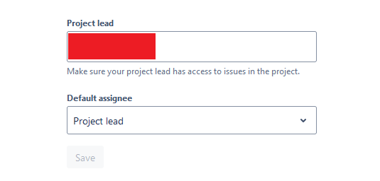

Here you go, I put in both the component and the project setting. I think I'll follow up on the other suggestion and try in a different project and different component.2025_01_23_ComponentAssignee.png2025_01_23_DefaultAssigneeProject.png

Hi @André - I think when creating the issue you might have to leave the assignee field as "automatic". Can you please check if that is being followed. The screenshot looks correct and here is the doc for ref - https://confluence.atlassian.com/jirakb/managing-components-and-default-assignee-selection-in-jira-software-projects-1385105793.html
