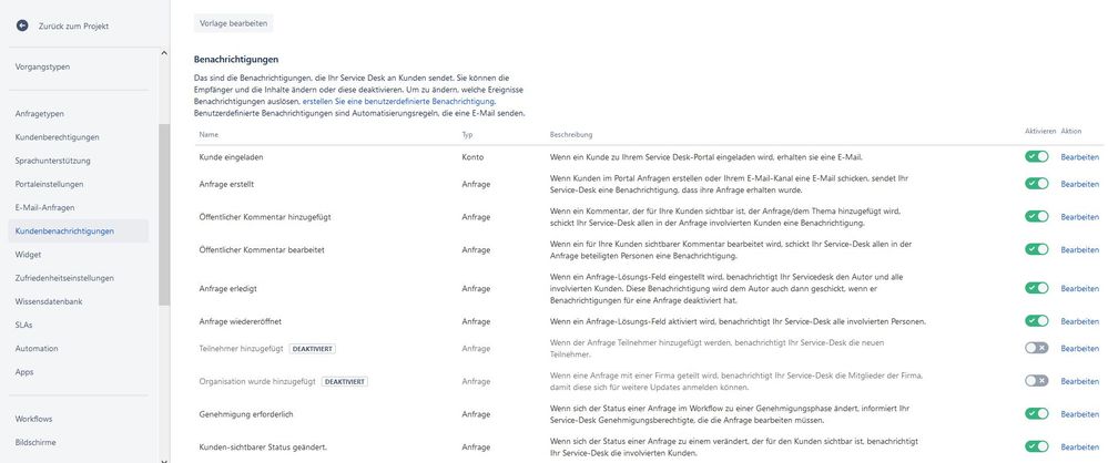

Just to make sure: I add the screenshot to double check we are talking about the same thing. It is in German language - but the increadible word "Kundenbenachrichtigungen" just means "Customer notifications". As you can see, I activated all of them but two.

It appears that you have everything set up correctly. In your original message you said you are using the "Reply to customer" option. That should generate a "public" comment, and so that should trigger the email to be sent.

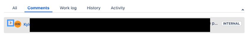

The only other thing I can think of is that the "reply to customer" feature may not actually be creating a "public" comment. Maybe it is creating an "internal" comment instead.
In the Issue Details view, if a comment in a service desk issue is not public, you should see that it says "internal" on the right hand side.

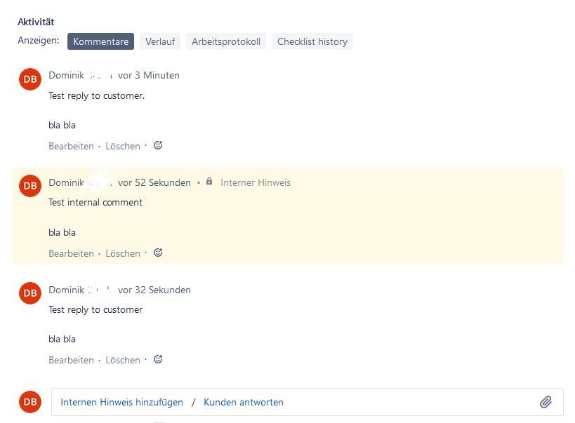

I checked the issue details view - but everything is as it should. I attach a screenshot. The yellow comment is internal. The two white comments are external comments. Neither internal nor external comments have been communicated to the participants. The only thing that is constantly being reported is when I change the status of any ticket.

1. Check the set up of the "Public comment added" notification itself. You can Edit individual notifications from the Customer Notification page. If you Edit that notification does it show "Customers involved" as recipients in the To field?

I went through every Customer Notification Rule again (clicking on edit for each). In customer notifications edit view I needed to add "Reporter (customer)" to each individual Customer Notification in the "To" field. Having "Customers involved" in there just was not enough.
