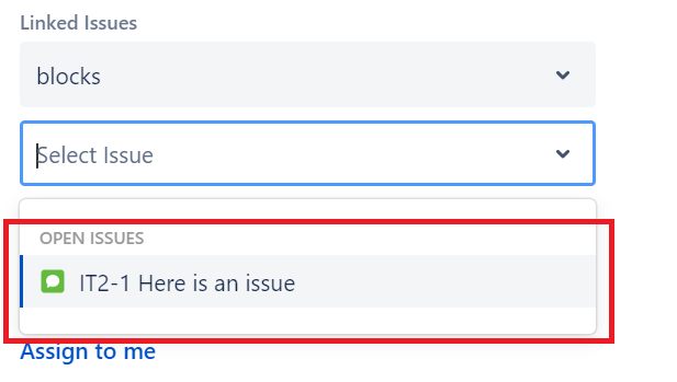

I have set up a default ITSM project with no customizations whatsoever. I have done the following:
  • Created a single ticket
  • Set the status to Resolved and set the resolution to Done
  • Set the status to Closed
When I created a second ticket, I saw a drop down for Linked Issues. When I clicked it, I saw the first issue appear.
I've seen other posts reporting that you must set a resolution, but I have done that in this case. Any ideas of what I'm doing incorrectly?

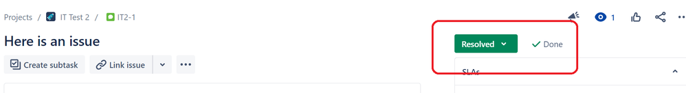

Picture below: Ticket is Resolved and Done

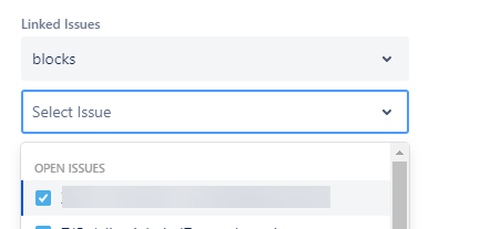

Picture below: New ticket has an option to link to the same ticket as an Open Issue

I do not believe it is closing it out. The screenshot above shows the ticket after I had closed it. It still shows a resolution of Done. Also this is a new unaltered ITSM project, so I do not believe it would do that be design.

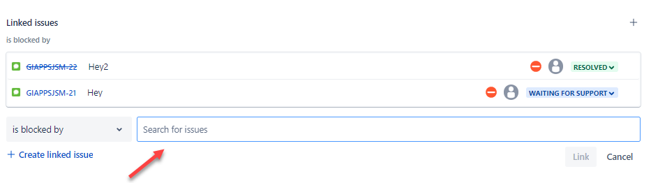

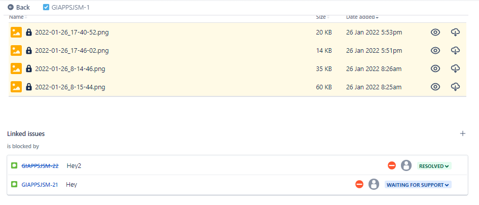

Another question for you - "New ticket has an option to link to the same ticket as an Open Issue" In Jira/JSM, when you link an issue to another issue (i.e. IT2-1 is closed with resolution set to DONE), if you link it to another issue, the issue will have "Strikethrough" marks over the issue key.
In the above example, GIAPPSJSM-22 is Resolved with Resolution value populated.  Keep in mind that when you search for the issue, the issuekey will not displayed with the strikethrough marking.  However, after the link is established, you will see the issuekey marked.
Lastly I don't see the "Open issues" display when I conduct the issue linking process.  Can you provide the exact steps that you got to the "Open issues" pop-up?
Generally, this is what one will see in the UI when conducting issue linking process -
Best, Joseph

Thanks again Joseph. I am not seeing any strikethroughs on tickets. Here are my exact steps to reproduce:
  • Create new IT Service Management Project
  • Create a request with a type of Get IT Help
    • Provide a Summary and Description, and save
  • Navigate to the ticket and select Resolve this Issue
    • When prompted, mark the resolution as Done and click Resolve this issue
  • Create a new issue by clicking Create at the top of the page
  • Scroll down to Linked Issues and click Select Issue
    • A drop down will appear. A section titled Open Issues will have one ticket in it, which contains the ticket previously resolved.

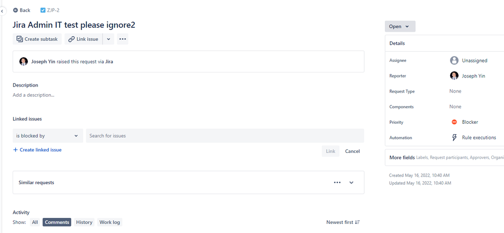

It seems to be a bug as I finally found the differences.  In the Create Issue screen and the Linked issues section, you are correct that resolved issues are listed under the "Open Issues" section.

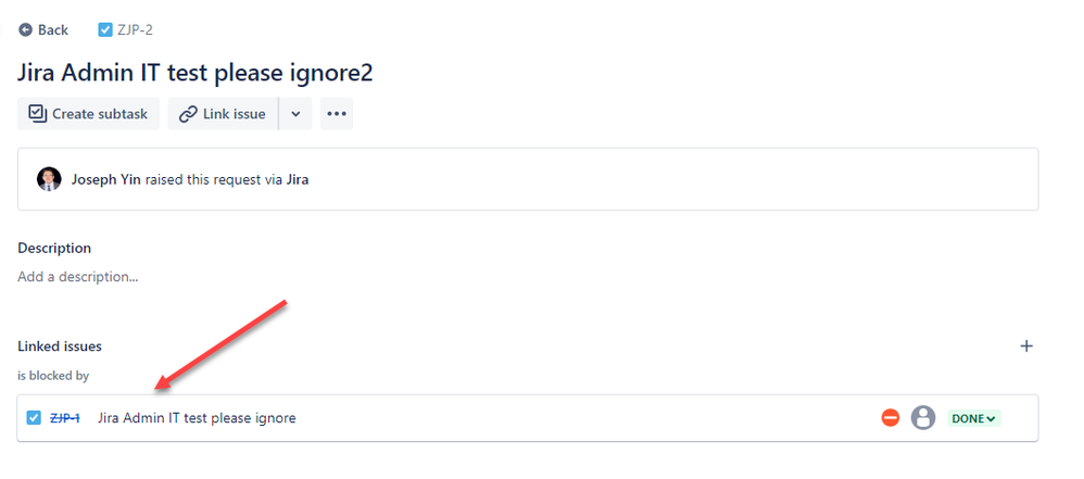

However, if you create the issue first without linking any issue to it, then you access the newly created issue (in this case ZIP-2 image below) and click on the Link Issue button, you will not see the resolved issues listed when you click on "Search for issues" field.  If you key in the resolved issue key, after the issue is linked to the open issue, then you will see the strikethrough mark.
The image below, I keyed in ZJP-1 (resolved issue with resolution set to DONE).
At this time, I would recommend you to submit a bug request to Atlassian Support Team (https://support.atlassian.com) and tell them that in JSM when creating issue via the Create button, the Link Issues is displaying resolved issues under the Open Issues heading dropdown listing.
We will be interested to hear what Atlassian Support Team have to say about this bug.
