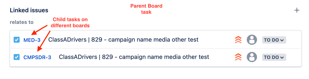

  • A task is submitted via service mgmt portal to a Parent board
  • The Parent board admin determines which child board (one or multiple boards) will need to work on the task
  • The admin selects the department from a multi-select dropdown. Once selected the automation rule will clone the task and link to the child project.
    • All of this works well if I could figure out how to copy previous comments into the new linked task

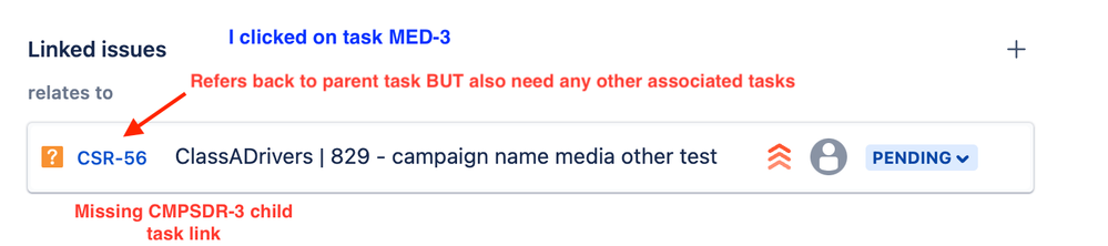

  • MY ISSUE: On the parent task you can see all of the child board links. When I click on any of the child board links I'm navigated to that task BUT I can only see the link back to the parent board. I need to see any links for all associated child boards on the child task in case one child board needs to reference another child board

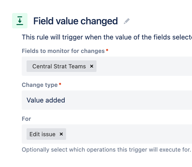

Hi Trevor,

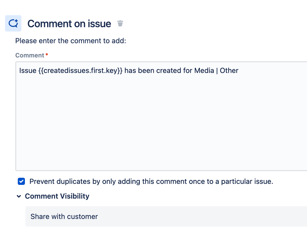

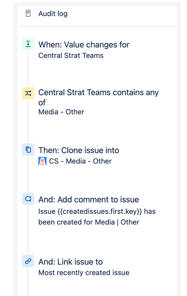

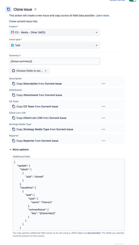

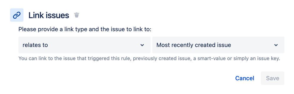

Can you share the rule where you are creating and linking the task? Have you tried to copy the comments from the parent task at the same time?
Trevor Overstreet
February 13, 2023
Please see attached screenshots for the rule.
I have not tried to copy the comments from the parent task. Would this be a separate rule? And what is the configuration to set this up? Thank you!

Okay, I think I am following you, but let me be sure. You have a Issue 123. You change something on it and it creates issue ABC, DEF, and XYZ. Issue 123 is linked to all 3 of them.
What you want is for all of the alphabets to be linked to each other - ABC is also linked to DEF and XYZ. Is that correct?
If so, you could probably accomplish that with a the #lookupIssues function. I am thinking it is probably a separate rule based on an issue being linked or created.
Trevor Overstreet
March 9, 2023
Hey John, do you have a link to review #lookupissues function?
And you're correct to "You have a Issue 123. You change something on it and it creates issue ABC, DEF, and XYZ. Issue 123 is linked to all 3 of them. "
"What you want is for all of the alphabets to be linked to each other - ABC is also linked to DEF and XYZ. Is that correct?"
Yes, correct
