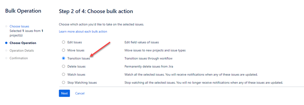

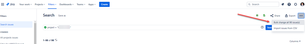

@Oscar Rene Peralta Sanchez -
Welcome to the community.  Yes, you can.  All you need to do is to construct your issue search query and conduct the "Bulk Change" operation to close out the issues returned based on your search.
Example -
One key thing that you need to verify is that your issues' current WF status has a valid transition to the CLOSED/DONE terminal status.  If not, you will need to modify the WF(s) to include a transition to the terminal status from the issues' current WF status first.  Afterward, then you can utilize the "Bulk Change" functionality to bulk close-out issues.

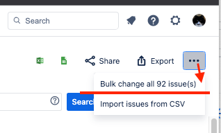

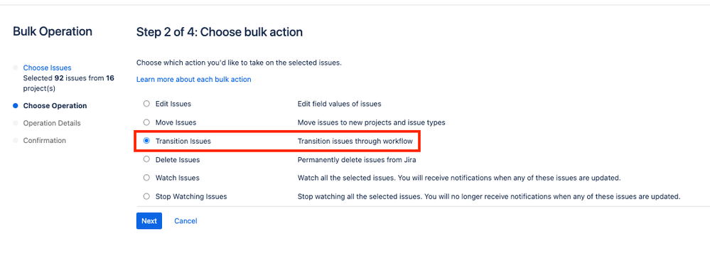

Hola @Oscar Rene Peralta Sanchez ,
Bienvenido a la comunidad Atlassian.
¿Cuál es su definición de un ticket que ha estado desatendido durante más de un año?
Podrías crear un filtro que busque problemas en los que la última fecha de actualización tenga más de un año:
actualizado < -365d y estado != tu estado cerrado y proyecto = tu proyecto Jira
Si tiene el permiso de Operaciones masivas, puede usar la opción Cambio masivo
...para hacer la transición de los boletos a su estado cerrado.
Hello,
What is your definition for a ticket that has been unattended for more than a year?
You could create a filter that looks for issues where the last updated date is older than a year:
updated < -365d and status != your closed status and project = your Jira Project
If you have the Bulk Operations permission, you could then use the Bulk Change option
...to transition the tickets to your closed status.
