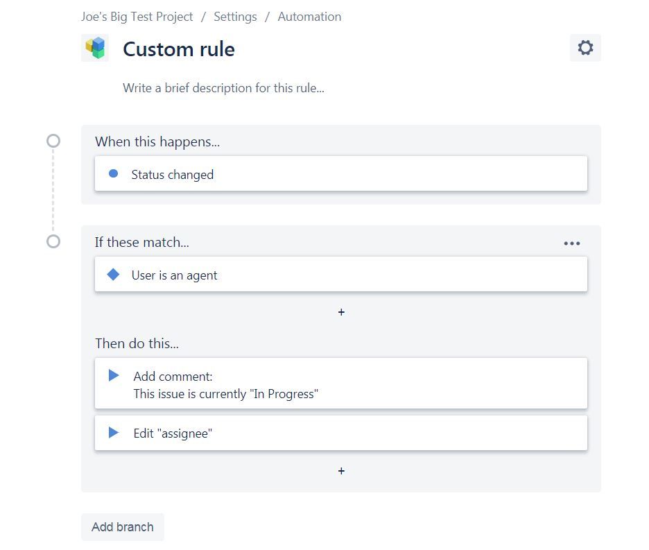

I took a shot at this Automation Rule. But not sure if it meets your needs.
David
August 21, 2018
Joe,
Thanks for the detailed reply. Looking it over, I don't think this would meet our needs.
