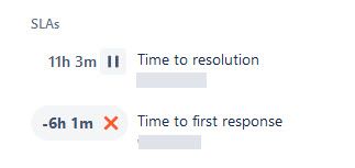

We have two fields "Time of first response" and "Time to response" to track our SLA's. We recently migrated an issue to a new request type and changes the status of it.
Unfortunately, this caused the date used for "Time of first response" to update to the current time and means our reporting is way off now.
