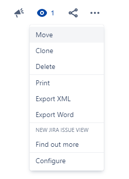

The move option only allows me to move the request from one project to another, not to change request type. I guess I'll have to switch to classic.

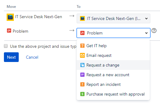

if you have compatible request types at hand, this should be possible:
jsd-cloud_next-gen2.pngHowever, classic could also be a good approach if you're going to customize your workflows - see https://jira.atlassian.com/browse/JSWCLOUD-17434

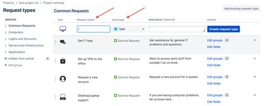

Thank you! May I add just 1 last question, how are request types considered compatible? do they need to have the same statuses?
Van
Petter Gonçalves
May 20, 2020
Hello @Van Kieu
To make a request type compatible when moving issues, the Issue-type must be mapped to it under project settings > Request type:
Additionally, you can map issue types to request types in a different way from project to project, so you should always consider the issue type and request type mapped in the project that the issue is being moved to.
If the issue is using an Issue type that is not mapped to the request type in the landing project, you will not be able to set that Request type.
Let us know if you have any questions.
