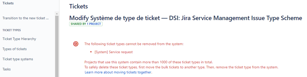

I have a project "A", my goal is to transfer 1500 issues to another "Ticket Type" in the same project.
During this manipulation, the system tells me that it is not possible to make more than 1000 issues at the same time. Do you have a solution to do this without notifying the users/agents/stakeholders of the change?
Capture d’écran 2023-02-16 163403.pngThank you in advance for your answers

Hi @UMONS ,
this is limited to 1000 issues because of the performance.
Is there any problem in doing it in two bulk changes?
The only other solution I'm aware of would be api calls, but I think this does not make any sense in your situation.

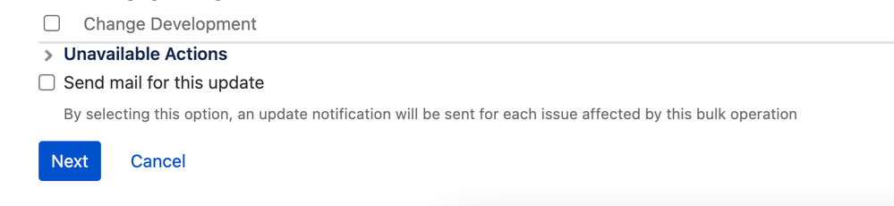

no it will not, there is a checkbox in the last step, to not email updates to users:

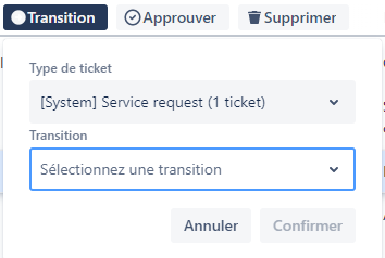

I do bulk with the "transition" option ?

At the bottom of the page, where you can edit the issue details, you should find the checkbox from my last screenshot. Make sure it is unchecked and nobody will get a notification about the update.
