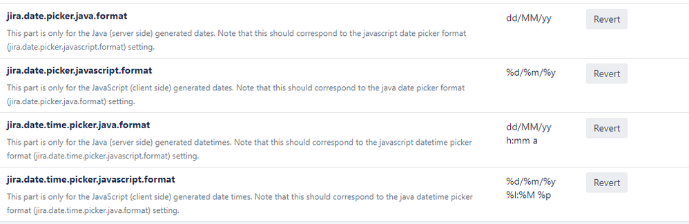

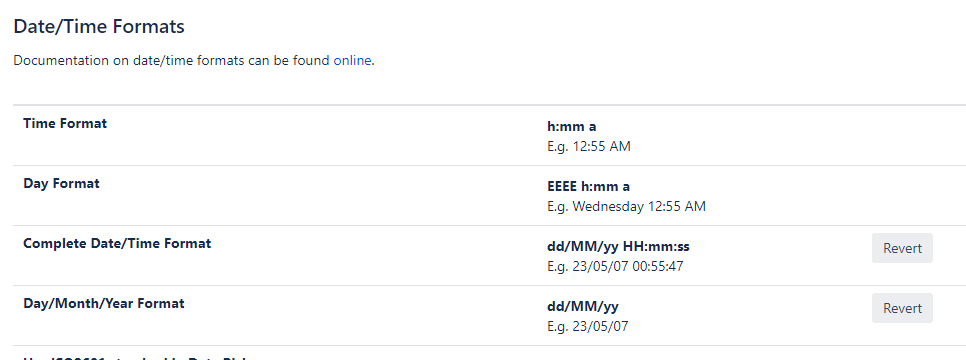

Hi @Connor
I had the same problem, and solved by changing date formats in look and feel
AAAND, in java dates/times configurations in:
System / General Configuration  + Advanced Configurations Buttom
Per my research in that time, one commands front-end, and other backend like downloading reports.
The format dates, if you need something different, need to search for Java and Javascript formats.
Waiting for your feedback.

Hi, I've tried setting to what you have above (and played around with some other options). Unfortunately this doesn't seem to work I'm still having the issue where sla's are being reported in a different format.
For example the SLA time to close has a ticket with the following
2h 15m
and another with the following
1d 2h (the hope was that this would instead report something like 50h 00m)
changing these settings around didn't seem to affect the column in anyway. If it helps this is specifically for exporting into excel not any internal report generation.
