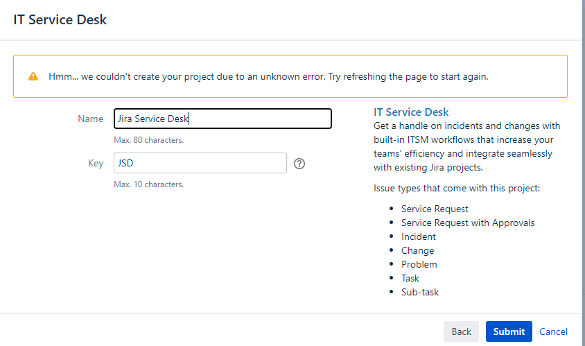

Getting the error as in the image here. The language is English and I have checked the details of Russian language issue.
Please help me in understanding the cause of this unknown error as I am new to Jira Service Desk.
