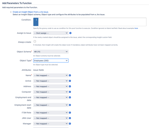

To create an object automatically from a JSD form, you will need to have the object schema and object type created in Insight.
Then you create custom fields for all the attributes you want to be filled in when you create the object.
Next, you set up an Insight post-function for Create object, and map your fields (or custom fields) to the Insight object Schema, Object Type, and Attributes.

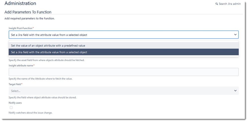

Here's an example of the post-function (second option from the bottom when you have selected "Insight post-function":
I hope this helps.

@Sandra _Mindville_  let me test it out!  Thank you so much!! :-)
Mory Soan
September 10, 2020
@Sandra _Mindville_ it did work.  I have another question, is there a way to add multiple objet within the same Service Desk Form?
