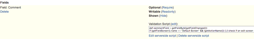

Daniel,
A behaviour script like this should hide the comment field on the "Edit" screen but not any other screen.
def commentField = getFieldById(getFieldChanged())
if (getFieldScreen().name == "Default Screen" && !getActionName()) { // check if on edit screen
commentField.setHidden(true)

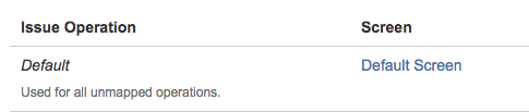

A better way to do it would be to check for the field screen name. Go to "Screen Schemes" in JIRA and find the one of "Edit." My screen name is "Default Screen", as I have not modified any schemes. Yours is likely to be different from the sound of it. See image below.
Once we know what the field screen name really is, we can edit my original script to make it work in a behaviour.

Awesome, that was definitely it, and sorry I missed the part in your original code for the screen name variable (otherwise that would have worked to begin with)!

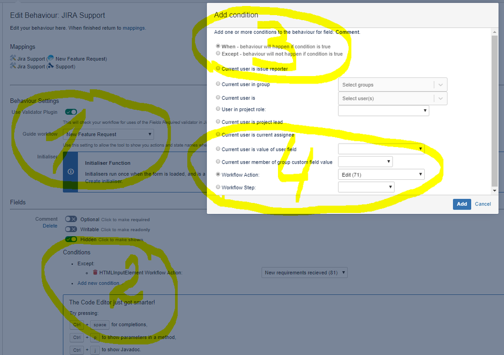

Anton Shevtsov
April 11, 2019
Hi Kumar,
Map the necessary Workflow and add Condition to hide the field on the particular Actions (for transition). See the attached screenshot - 1 - Select Guide workflow; 2 - Add Condition; 3 - select whether hide field on the transition screen or show only on this transition; 4 - select necessary transition.
Regards,
Anton
