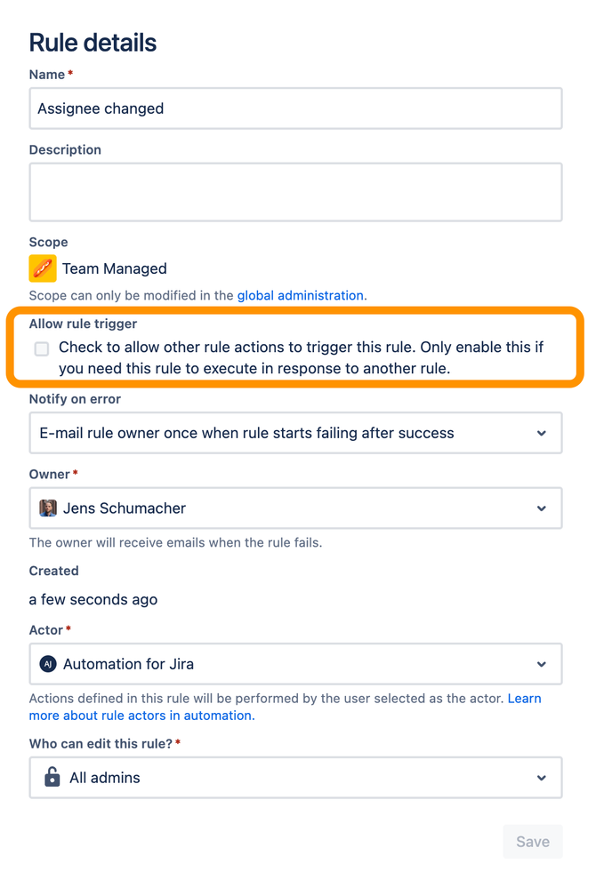

The first rule can be activated by the second rule, but it is crucial to explicitly indicate that this rule can be activated by other rules in order to prevent infinite triggering loops.
See the screenshot below for where to find the setting.

Ste404
July 3, 2023
ah dammit.. I was certain I checked that box.  I checked it for the first one and not the second one..  what a dope!!
THANKS :D
Problem solved.

I agreed with what @Jens Schumacher - Released_so suggested to the checkbox to "Allow rule trigger" option against your automation rules.
