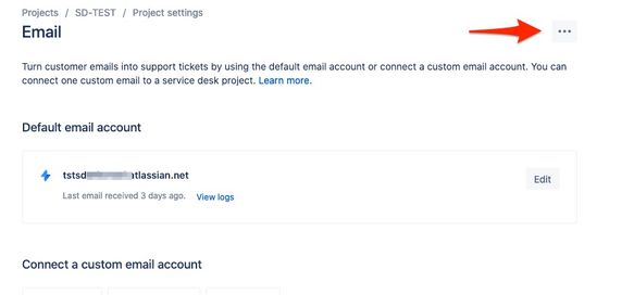

Can you provide a screen shot. Here is what you should see

unless you are on a NG service desk which is a different beast altogether.

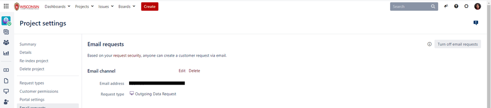

Thanks Jack. Mine looks very different. Sorry, I'm new and know only so much:

Ah, my bad, you are on server. I don’t have access to play with that unfortunately. Did you try the Edit link that is shown? How about in the Request types page? Also check out support.atlassian.com and search documents
