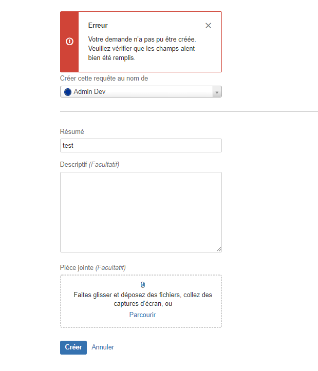

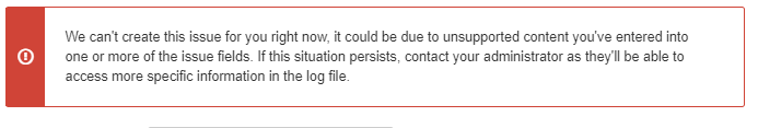

I have two problems, I think it the same resolutions. I can't make any reindex, it just say a problem is occured.
in another way, I can't create an issue, the applications says that not all of the required fields is filled and when I try to create somethings or that I write some bad field.
To explain the situation, I delete field from the custom fields which was in some issues and some screen (already use) and I delete some request used to created issues. Does it come from here?
Somebody have an idea ?

There's not enough information here to tell you about the indexing.  The error message might tell us something.
For the create issue problem, it sounds like you removed fields from a "create issue" screen, but did not update the "field configuration scheme" to make them optional.  Either put the fields back, ore edit the field configuaration to make them optional (project -> admin -> fields is the starting place for finding this)

Thank for your answer.
I went to the log file and I found that the system haven't space to work on, that's why I have all  theses problems.
I don't know if you know that but is that possible to change the path for the indexing snapshot ?
