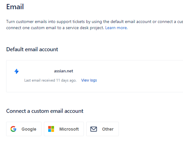

Hi,
I can't add a custom email account in Jira Service Desk.
Nothing happens when clicking the three buttons in the bottom.
I have tried multiple browsers with all extensions disabled but nothing happens.
Any clues why?
2020-01-27 14_40_06-IT support - Edit Request Type Group - Service Desk - Brave.png

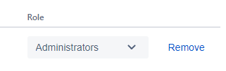

Also, there is a bug related to this as well where only people added to the group "Administrators" are able to add the custom email.
If disabling and enabling the email channel doesn't work, you need to talk to your site administrator for them to add the group to your profile.

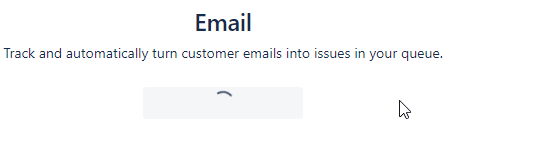

Hi Angélica,
I just disabled and re-enabled the email support but I can't click the email buttons after.
I don't really understand the workaround presented in the bug you sent me.
My account is already added as administrator for this project.
"Workaround
Include the agent as a Jira Administrator."
Best regards Don
Angélica Luz
January 28, 2020
Thank you for the details, Jon.
You are a project administrator and not an administrator of the instance.
With that said, a site admin of your site must go to Screenshot 2020-01-22_09-49-23-535.png > Administration > Users and add the group Administrators to your profile.
