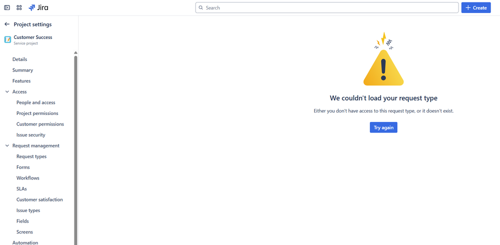

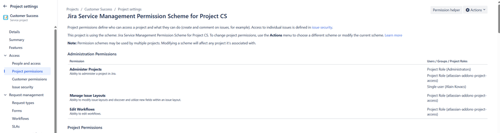

Hello, I have a strange issue with seeing request types. I'm a site admin, all of these have been working perfectly well until a few days ago when I tried accessing them and they don't seem to work and I get the following error. I know that the request types are there, because a colleague with exactly the same permissions as mine can see and edit them. Also, it's me that created them in the first place..
same when I try to access them via
This happens for all projects. I am a project admin on all our JSM projects (here an example). I have even added myself individually. I can do everything else in the JSM projects, but see/edit request types.

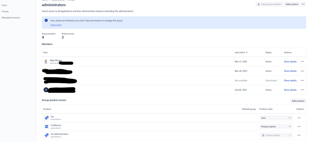

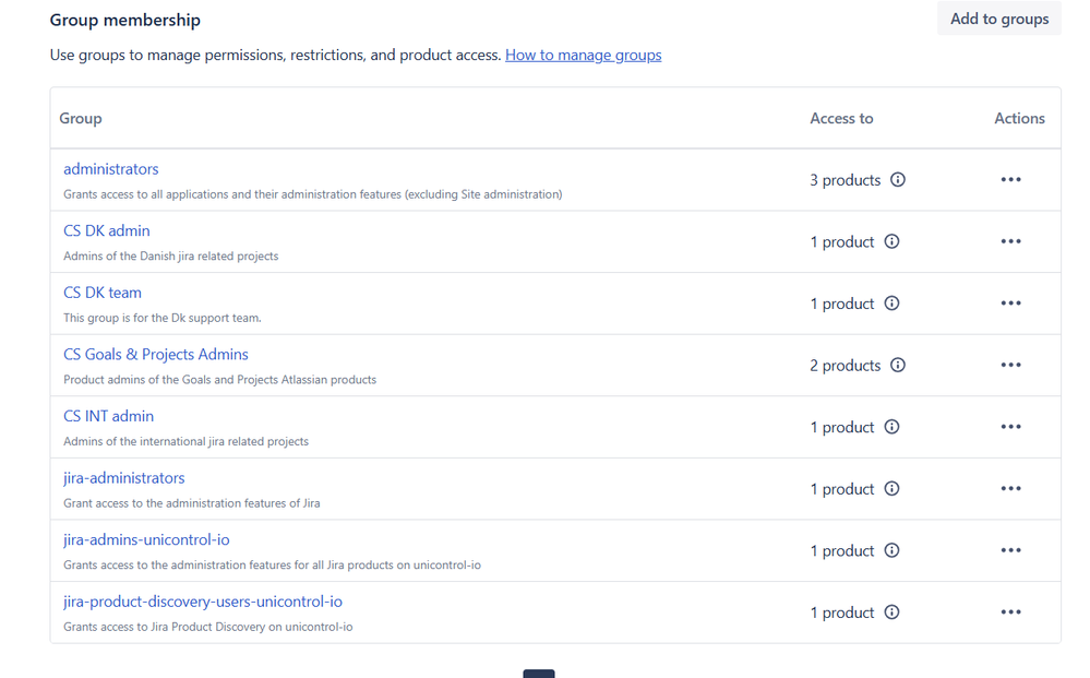

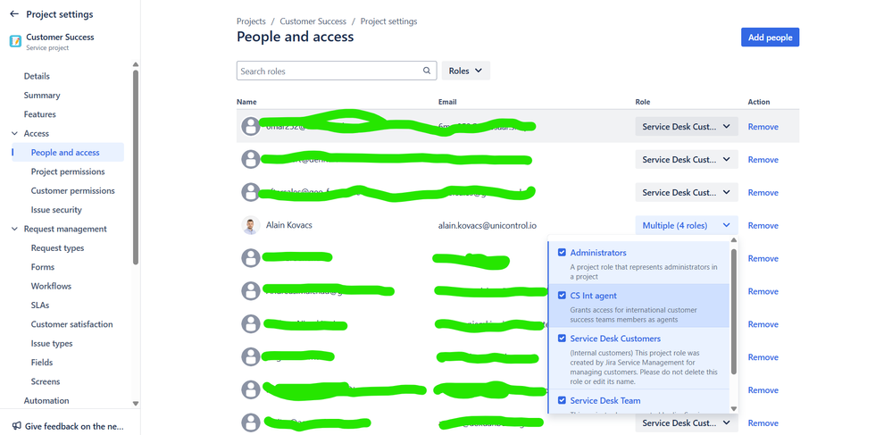

I am an agent in JSM and among others, I belong to these groups
As mentioned, it seems I have all permissions I need, and it worked perfectly well until a few days ago, and I'm the only person who goes and modifies these things, even though others might have permissions.. To my knowledge nobody modified anything as we did not do any changes to anything remotely related to this within the last few days/weeks.

You need to grant yourself a JSM license and add yourself to the default administrators role in the project.

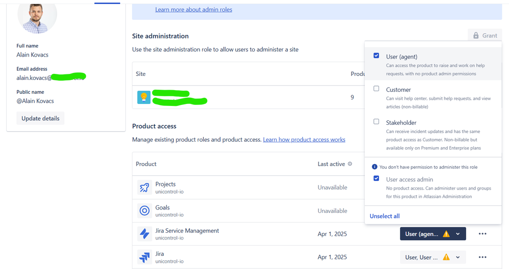

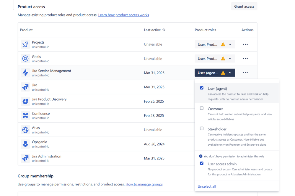

Thanks for the answer. I am fairly sure I already have both, but maybe I'm misunderstanding you.
I have a JSM license, I'm an agent and I can do everything as an agent
and I am also an Administrator (I can do everything an Admin can, apart from the Request types)
Alain Kovacs
April 1, 2025
just as I finished writing this, I have tried again, and it started working.. I'm a bit lost. So I certainly had a JSM license, but it is true that it might have had something with the "Administrators" project role. For some reason or another, the "Administrators" role had nobody in it, but I am absolutely certain that this is how it has always been. Nobody went there to remove people. I have added myself and some groups to the project role and it started working! Thanks for steering me in the right direction.

I figured it out...
I was added to 1 additional group called 'jira-servicemanagement-stakeholders'. This group had no permissions on the JSM Permission Scheme, which somehow counteracted my Administrator role permissions. Feels like the Administrator role should surely be the highest level of access?!
