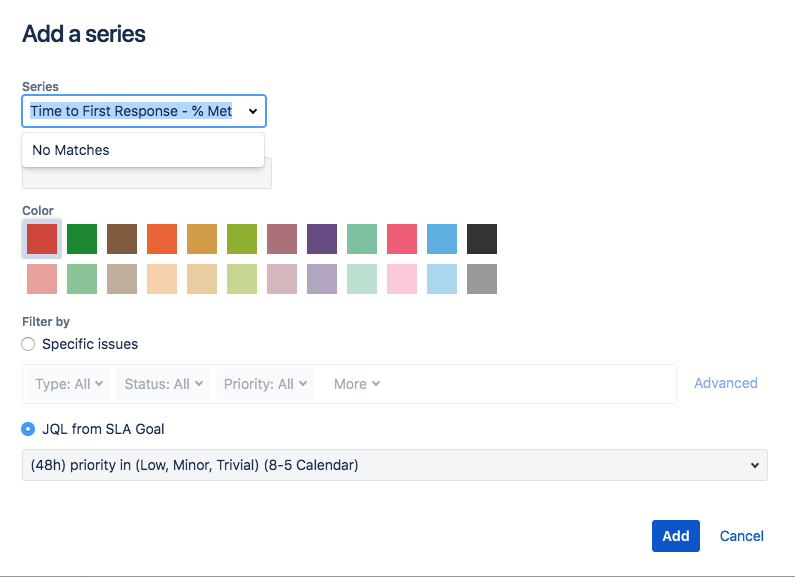

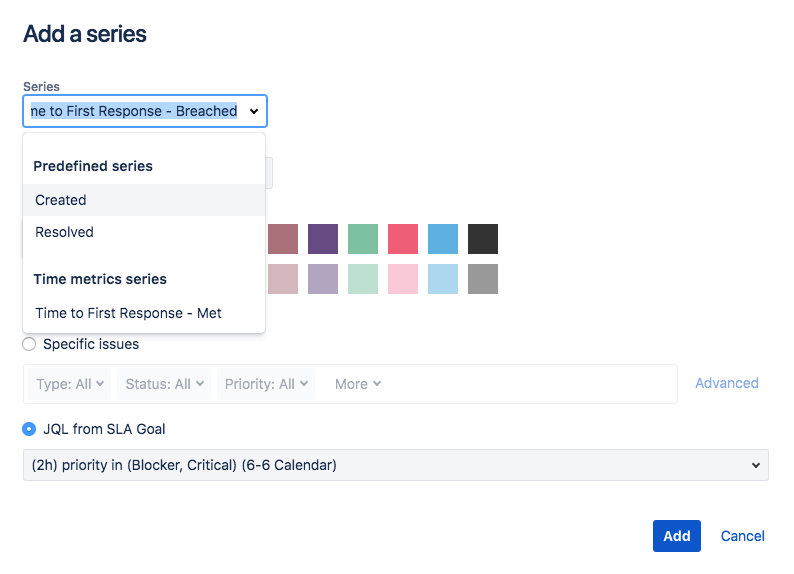

Glad that I found this thread. I am setting up my reports, and where some projects display the Time Metric series in the list others do not. All of my projects have the same metric configurations, so I'm stumped as to why they do not display the same drop-down options in the report setup.
Did anyone ever find other issues that might be causing this other than the SLA metrics values not being set?

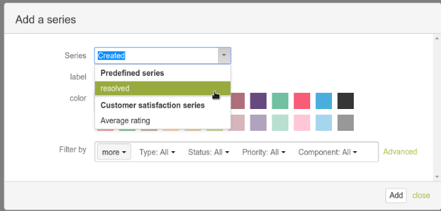

I'm having the same problem.  I'm using the Cloud version, and the only Series I see in custom reports are Created, Resolved, and Average rating.
Ruben, did you find a solution for this? I assume it doesn't require the paid plugin mentioned above.

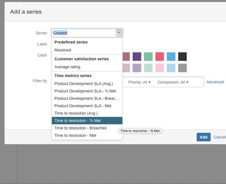

Jack Brickey
August 15, 2017
i'm confused by this. I'm on cloud as well and here is what I see...
Susan Ostreicher
August 15, 2017
Jack, thanks for this screenshot!  It helped me figure out the problem: I did not have any metrics under SLAs.  I created a couple of metrics there, and sure enough, now they're included in the series dropdown for reports.

Ruben, if you add a new report and click Add a Series you should see Time to resolution as an option. Can you check that?
Ruben
July 5, 2017
No we don't see that at all. these are the only options we see.
