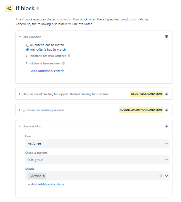

So Update, I found a way simlar to what I described above.
1. created a group called "vacation"
2. when agents are on holidays they get moved into this group - the drawback here is that an admin needs to do it. would be best if users could mark themselves in and out of this group when they are going on or coming back from vacation.
3. the IF block of the automation rule checks if the ticket assignee is in the group vacation when a comment is left on the ticket (i.e. if the customer writes to the request),
4. The Action triggered is an auto reply (as comment added to request) is sent to the person who left the comment. (also a status transition to waiting for support in our case).
5. the IF else block is essentially then the same with the vacation group condition removed and the action thereafter is status transition. (or one could just do nothing).
So far it looks like request participants somehow don't get the notification that the autoreply comment was added but that could be linked to our notification settings.
I would still prefer to set this up in a more elegant way than having to move the assignee agent into a vacation group. I am thinking this could be achieved with a tag/ label that the agent adds to the request (e.g/ "vacation" ) then the rule can look for that value in the label category instead - this way the onus is on the Agents to mark and unmark their requests when they go on leave and will get away from the admins having to do this work.
