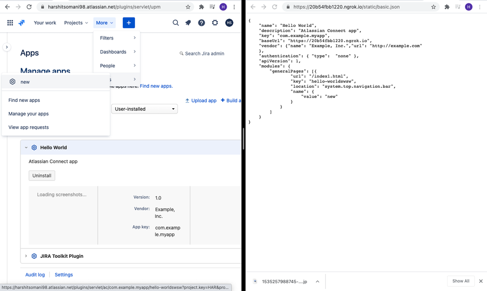

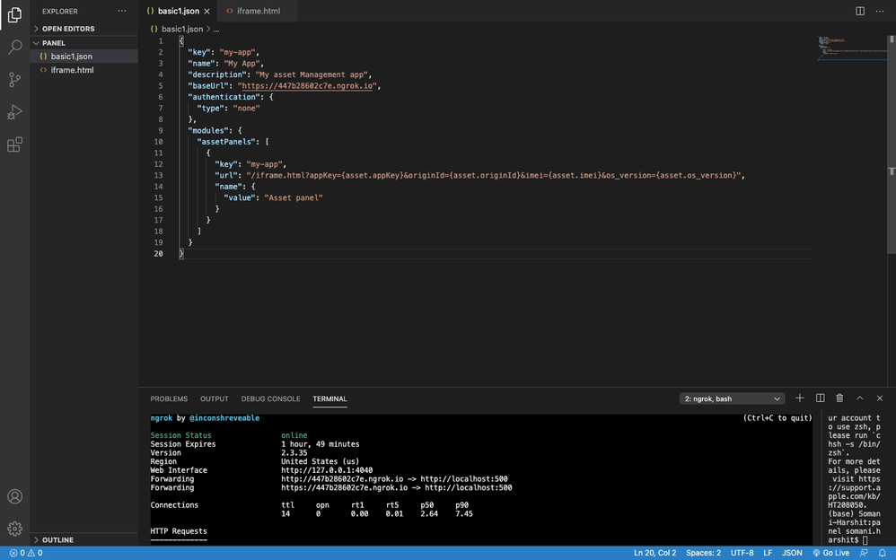

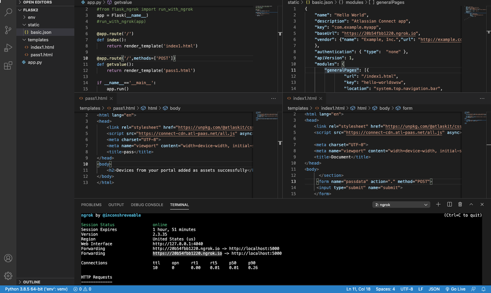

@Prince Nyeche - ELFAPP I have created an app using python(flask,flask-ngrok).I am able to load the apps successfully with the links(in my case link is 'https://618834426a38.ngrok.io') generated using flask-ngrok.
But when I am uploading it as an app to jira its showing "Problem accessing the file https://618834426a38.ngrok.io/basic.json" error message,can you please help me with it
Your connect file should be "atlassian-connect.json" where it contains the configuration.

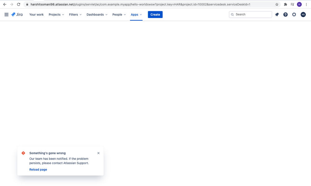

@Prince Nyeche - ELFAPP ,yes I did it so,my app is normally working in the browser, and when I install the app in jira,it is not even opening,I used ngrok to host the app,Are there any prerequisite steps I have to follow if I use python flask
Hey @Harshit Somani

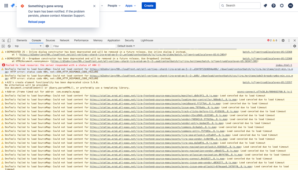

Can you check on your developer's console to see what type of error that is thrown? that should add context on what's the problem.
@Prince Nyeche - ELFAPP I am not able to figure out the problem

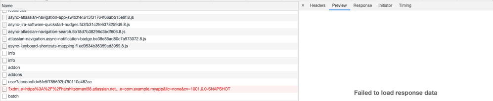

Can you check under the network tab while refreshing the page, to see the error message there?
@Prince Nyeche - ELFAPP ,now I am getting the above errors,I used python ngrok flask for deployement,in the begging it gave a warning that "this is a development server do not use it in a production deployment",what can I do
Hey @Harshit Somani
it seems that your ngrok is loading an insecure page, each time you load it up do you get a different url? Can you ensure that it's using https rather than http.
I don't think the production environment has anything to do with it, because the example from Atlassian developer blog does work. so check other factors such as the https thing.

you are suggesting to use https instead of http,I think thats what I did,but still can you tell me what is the best way to do it?for your reference I will give you the code,Please let me know the solution
I tested your code from here, while it is able to load via ngrok.io when installed on an instance, it returns 404 when fetching the index page. Most probably due to the tunneling or being embedded on an iframe, which makes the page not to be retrieved. (not fully certain here)
127.0.0.1 - - [25/Jan/2021 21:15:20] "GET /index.html?xdm_e=https%3A%2F%2Fexample.atlassian.net&xdm_c=channel-com.example_test.myapp__hello-world&cp=&xdm_deprecated_addon_key_do_not_use=com.example_test.myapp&lic=none&cv=1001.0.0-SNAPSHOT HTTP/1.1" 404 -
127.0.0.1 - - [25/Jan/2021 21:18:06] "GET / HTTP/1.1" 200 -
I will suggest, you use Heroku instead to host this test app in order to run your test.

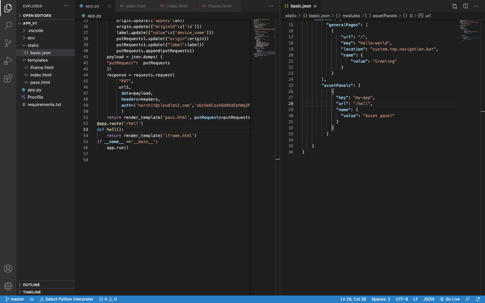

@Prince Nyeche - ELFAPP ,I tried to deploy using heroku, here is the link https://harshitsomani26.herokuapp.com/static/basic1.json

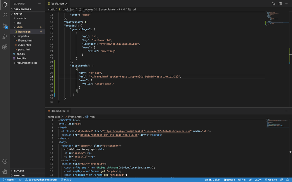

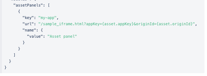

To view the Iframe in the app,this(the image atttached) is how it is prescribed to give commands
@Prince Nyeche - ELFAPP But I wont be able to give the same because I wont access the iframe directly I will access the Iframe from my python flask,so here how can I give the commands
Hey @Harshit Somani
Basically that is just an endpoint. on flask, you can create an endpoint as sample_iframe.html and have query parameter with the url and you can use a variable rule to write out the string you want flask to receive in the function. The url_for function is particularly what you will use this for.
you can also look into of the ways to capture those values by using the args property in the request and then process it. I think you should really explore more on flask in order to know how it can be done.

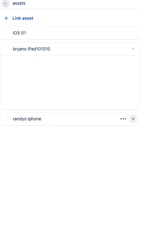

@Prince Nyeche - ELFAPP ,I don't think I have much problem over there,my main problem is when I include the module named 'asset panel' as shown in the above image,all my previously addable assets are getting deleted,if I don't include that module everything is working fine,whats the problem with that module
@Harshit Somani I'm not particularly sure why probably you can perform some troubleshooting steps to determine why it happens.

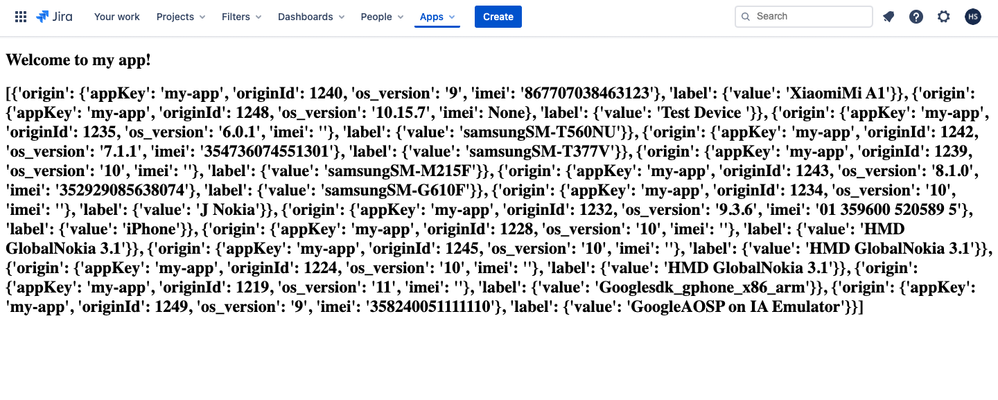

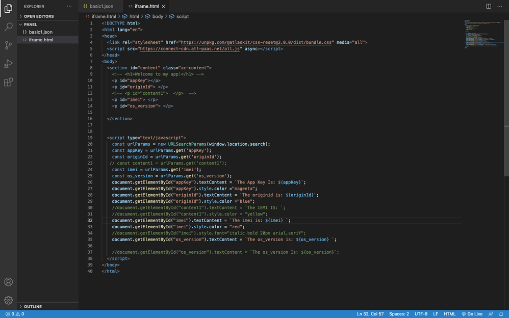

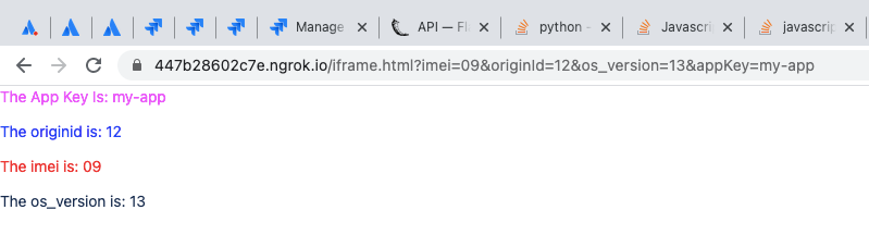

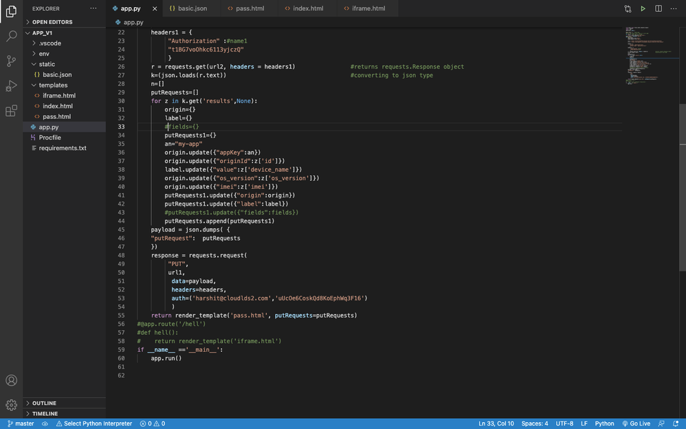

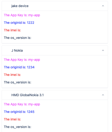

@Prince Nyeche - ELFAPP why is that I am able to display only appkey,originId and not imei,os_version in jira's Iframe,I am able to display all of them in the web but not able to do so in Jira iframe.
@Harshit Somani according to the docs for PUT method, it accepts origin being a dict, however I'm not sure if that includes additional fields other than appKey and originId.
