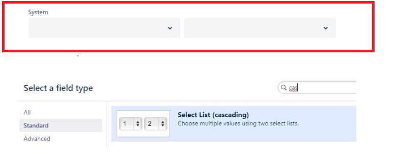

Currently, Cascading select list can only accommodate 2 dropdowns. can I make it up to 3 or more? (ex. Parent -> Child -> GrandChild)

No this is not possible.
The referenced Atlassian issue above has been open for 18 years!!!, so don't expect to much.
I would suggest to use the free app custom field suite from Caelor

Hi @Ceejie Cecilia
There is an open ticket. You can watch and vote: JRACLOUD-7936
Please take a look at add-ons in the marketplace:
https://marketplace.atlassian.com/search?hosting=cloud&product=jira&query=Multi%20Level%20Cascading
