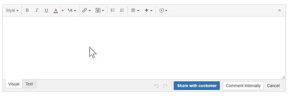

Thanks Jack. At the moment the only buttons that appear when commenting on tickets are share with customer(which changes the status) and comment internally. Is there a way to add a respond to customer button?

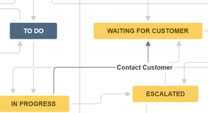

Emma, what we have done and what Jack is suggesting is to add a transition to your workflow. Here is a portion of ours; see that there is a "Contact Customer" transition that moves an issue from "In Progress" to "Waiting for Customer". We use a simple comment screen for the transition.

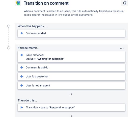

and here is my automation for transition on comment....
hopefully this is clear. Please let us know if you need more info/assistance.

I would like share with customer to remain in progress and respond to customer to change to in progress. But the problem I have is that I cannot see the respond to customer button when commenting on a ticket.

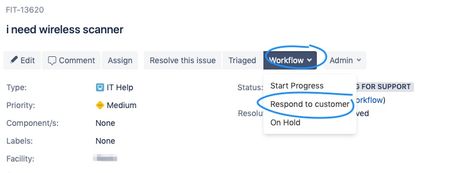

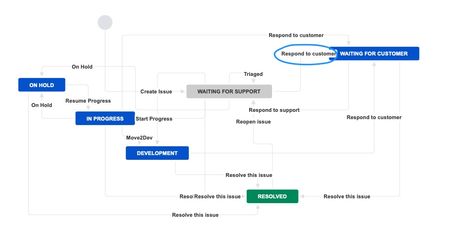

the "respond to customer" is not part of making a comment. it will be at the top of the issue as it is a transition. see if these images help...
Here is my workflow that illustrates the transition to-from the W4S and W4C statuses...
here is where you find the transition on the Issue Detail View screen...
