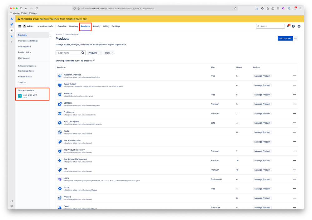

To configure the feature, you will need to navigate to the Admin Hub (admin.atlassian.net), then to Products (or Apps, if it's been renamed in your instance already), then to the instance you want to configure.

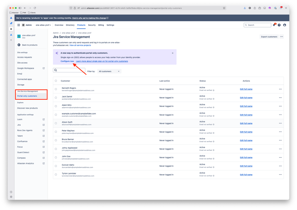

Once here, find the Jira Service Management section, and then click the "Portal Only Customers" option. This is where you will be given the option to configure SSO for these users.

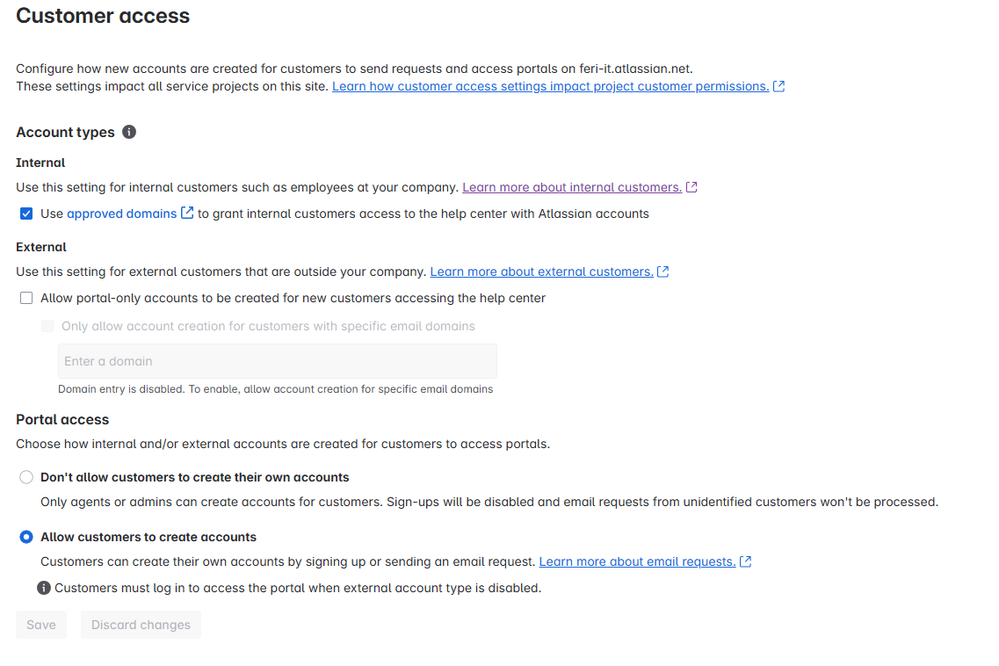

I would just want to know beforehand whether it works at all with the settings if “portal only customer” is not even selected. Please take a look at my settings, I haven't selected “portal-only account” for External, so I'm asking whether it works at all with the settings I have there.

@Antonia To be clear, you're referring to the "Allow portal-only accounts to be created for new customers accessing the help center" option, under "External", yes?
This setting is specifically for external users, allowing them to create Atlassian Accounts that are automatically granted the "Customer" permission in your instance, if they don't already have an account with that access.
This setting should not impact the ability to enable SSO for your internal users.
I'll reiterate, if you are aiming to enable single sign-on for accounts that are considered part of your company or organization, the proper way to accomplish this is to utilize Atlassian Guard and enable SSO for your entire site.
Here is the guide for how to enable SSO via Atlassian Guard: https://support.atlassian.com/security-and-access-policies/docs/configure-saml-single-sign-on-with-an-identity-provider/
The "Portal Only SSO" option is designed for customers that are not part of your organization.

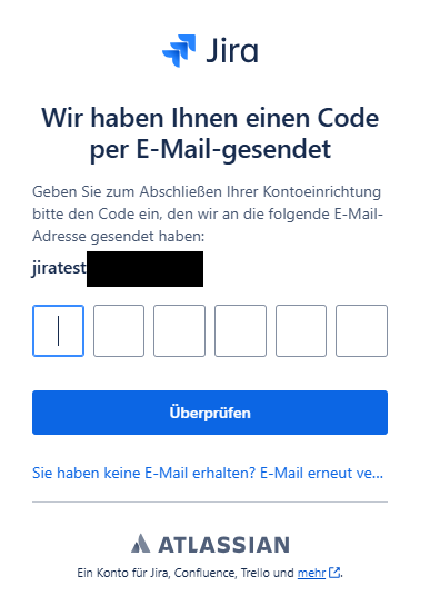

@Robert DaSilva Thank you very much for your help. Unfortunately, I don't know if the article will help me, because these are not external users. They are internal, so we are all in one company. And yes, I mean, when a customer (internal) clicks on the customer portal, he first has to enter his e-mail address there, and then he receives a verification code (I think one-time) by e-mail. And then they have to enter the code, I think it's six digits.

@Antonia Are you able to share a screenshot of the verification screen? That might help narrow down what settings need to be adjusted.
So I open the customer portal, enter the e-mail address there, then I click on “OK” and then click on “Continue with Atlassian account” and then I have to log in to Microsoft and then I get the code

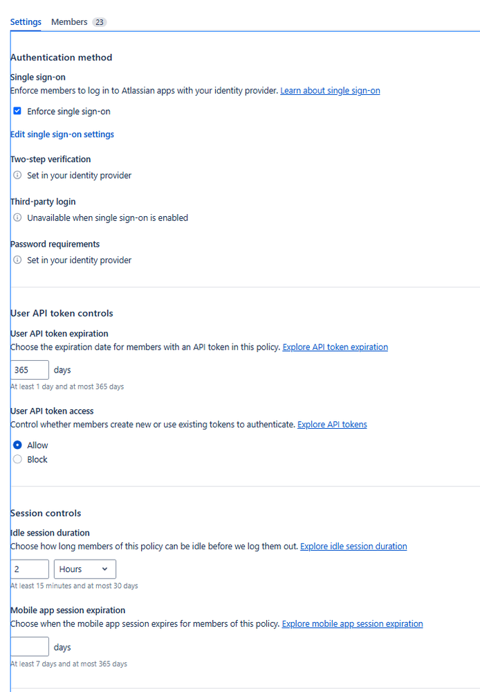

Guard Settings: (I've already been to the settings, and it tells me that I should make the settings in Intune, but I can't find any settings there.)

@Antonia Can you confirm the user you attempted to log in with is part of the "Members" tab in the Authentication Policy you just shared a screenshot of?
Antonia
June 3, 2025
@Robert DaSilva yes, he is in there.

@Antonia And are you noticing the request for verification every time you log in, or is it only showing up the first time.
If the request only shows up the first time, it could be related to Atlassian Account verification, as part of the account creation process, and not something we can control.
If this happens every time, then the setting is likely configured in one of the places I have already identified, or is a new requirement for JSM projects that Atlassian hasn't given control over.
Antonia
June 4, 2025
@Robert DaSilva
its only the first time when i log in, I wonder if there is any way around this?
Robert DaSilva
June 4, 2025
@Antonia @No, the code is used by Atlassian to verify you own the email address you used to sign in. I don’t know if any way to disable the first time verification.
