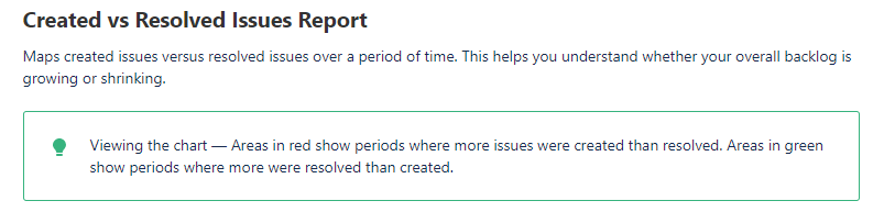

Go to Reports then scroll down to Created vs Resolved Issues Report.
From there you should be able to configure a report to show tickets closed/tickets open.

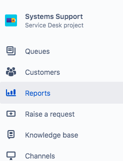

Ah thanks, when I look at the logo for your reports tab it looks like you're in Jira Software, is that correct? My question pertains to Jira Service Desk (screenshot of my reports tab below):

It's the same report for Jira Software, Service Desk and Core.  The differences you're seeing are because one of you is on Server and the other Cloud.  But the report still does mostly the same thing, just that the options are a little different.

This report is not in %, it's coded to show actual numbers, not proportions, on both Server and Cloud.  So it's not quite what you asked for.
I think @Larry Loughan and I are trying to get you as close as we can to the information you need to get - this report tells you the raw number of opened and closed issues, so you can calculate percentages from there.

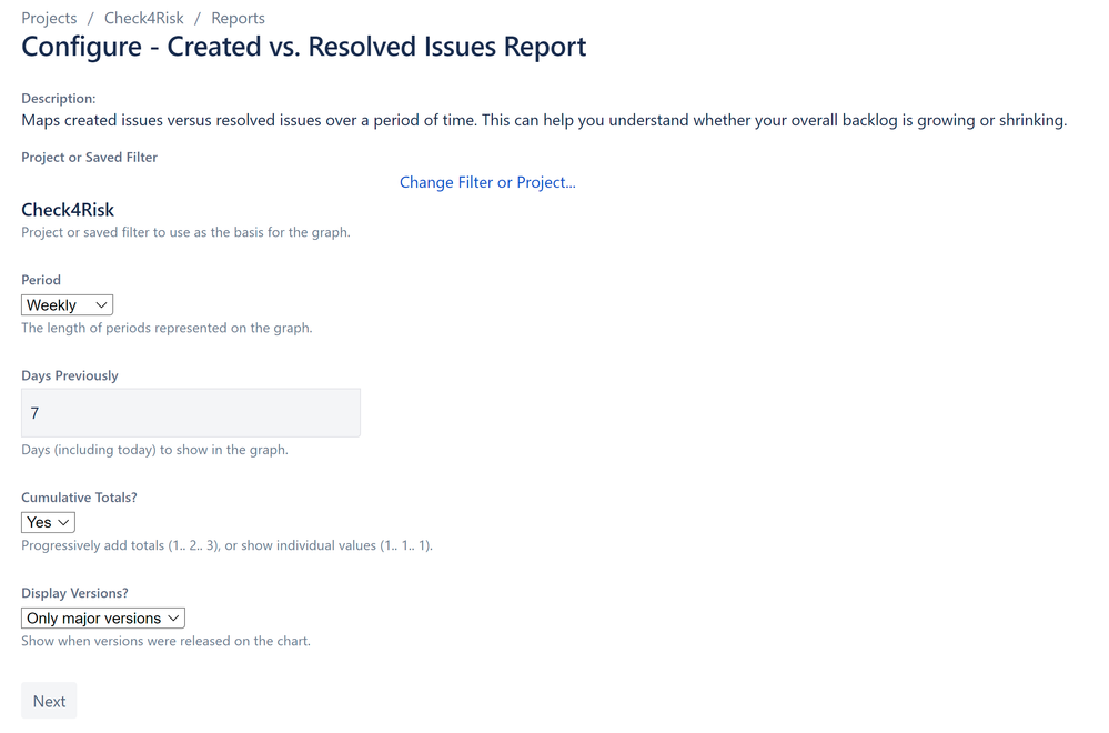

This is what I could find to view this chart not sure if you can change it to a %.
