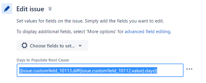

I am attempting to calculate the difference between two custom fields (in days) and populate the result into a number field.
See screenshot below for what I have entered.
I get an error message which states "Additional fields contains invalid field(s) in 'update' or 'fields' section: Custom Field Name" but this does not tell me at all where the issue is. I have tried various variations but get no where.

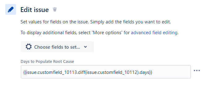

I recreated this, using the Start Date and End Date fields, and using this smart value:
{{issue.customfield_10123.diff(issue.customfield_10456).days}}
^ And it worked as expected.

Thank you for your quick response. I have tried the same as you entered but it still does not work for me:

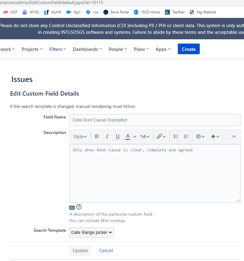

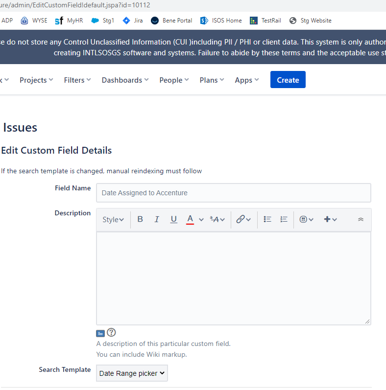

Below are the screenshots of the custom fields so you can see their IDs:

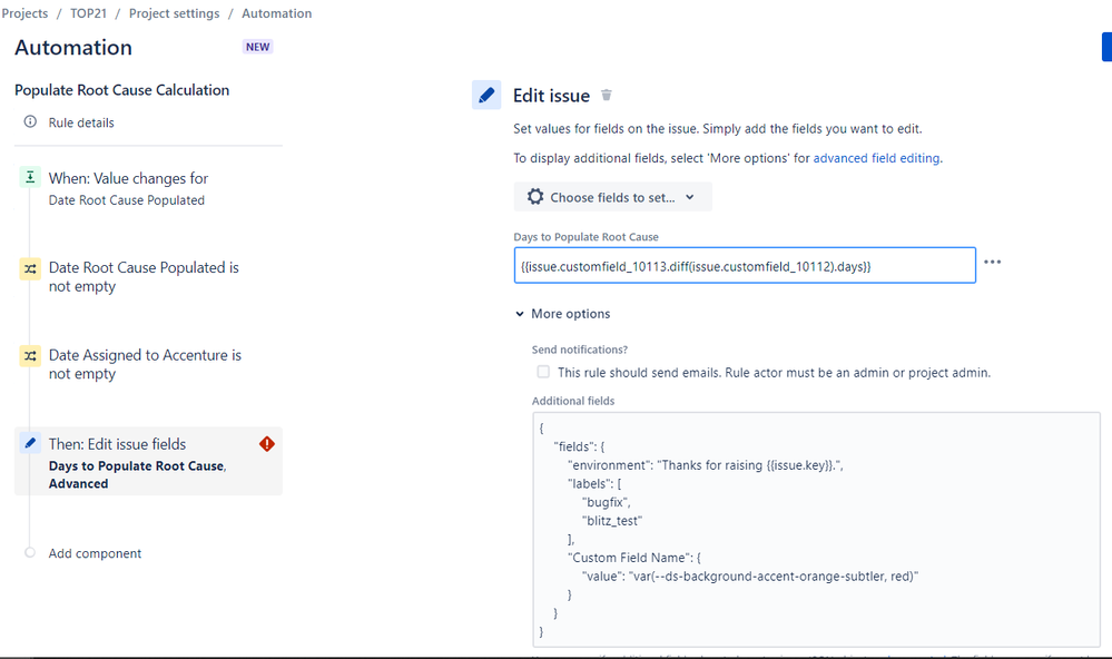

Here is the rest of the rule, but there does not seem to be anything unusual? I should explain I am very new to this so I am probably missing something basic.

@Dave Jones close the additional fields (JSON) which you have opened ("more options").
Dave Jones January 8, 2023
:) Thank you. That was it.
