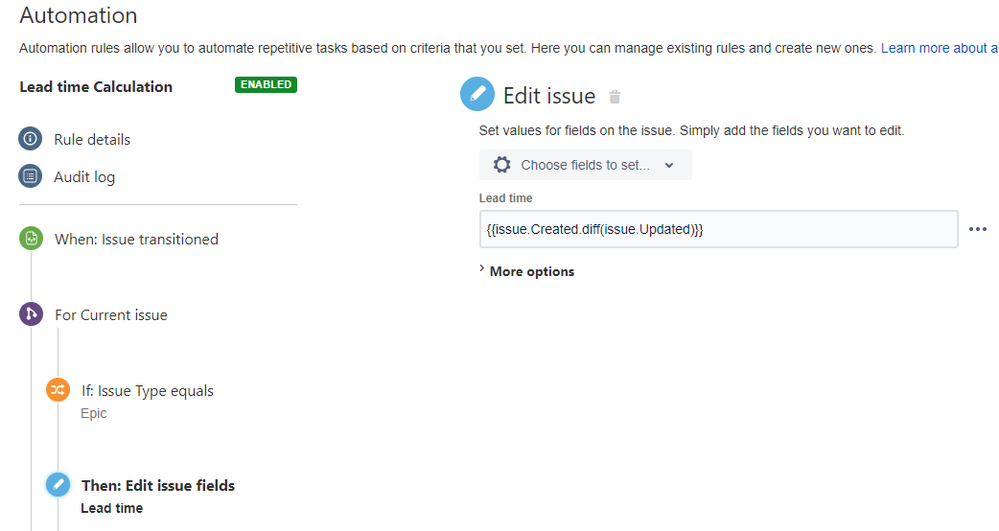

Sharing with you the automation that I have created to calculate the Lead Time.
This rule works well.

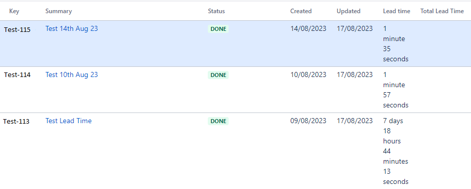

When this rule is executed the value obtained is displayed on the dashboard as follows:
The second part of my working is to calculate the sum of all the values obtained in column Lead Time.

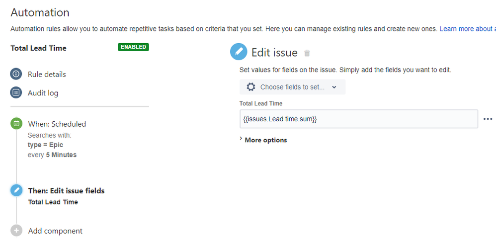

To achieve this, I have created another custom field "Total Lead Time" and I have created another automation as follows:
However, when this rule is run, I'm not getting any result in the dashboard.
Let me know if anything is unclear to you.
Thanks that clarifies things a bit. The one thing I am still unclear on, or rather confused by is that in your first rule for leadtime, you seem to be focusing on epic issue type. Is lead time associated with the epic, or rather the stories under the epic? Assuming that your goal is to sum up the lead time of each story and place that value into the epic (parent) for those stories, then the following may be more of what you're looking for in your second rule.
"fields": {
"Total Lead Time": {{lookupIssues.Lead Time.sum|0}}
please note that I am doing this a bit from memory and have not been able to verify syntax, etc. hopefully it is close enough to get you there. 😉

I tried to adapt my automation as per the rule you had suggested but, it's still not working.
Hi @Krishtee , if you were only using a single issue type, epic, then I don't understand where the summation would be stored. Let's say you have 10 Epics, which epic would have the total lead time summation for the other nine Epics? It looks like you are looking for a table column summation feature. This does not exist natively and if it is something you need there are a few options.

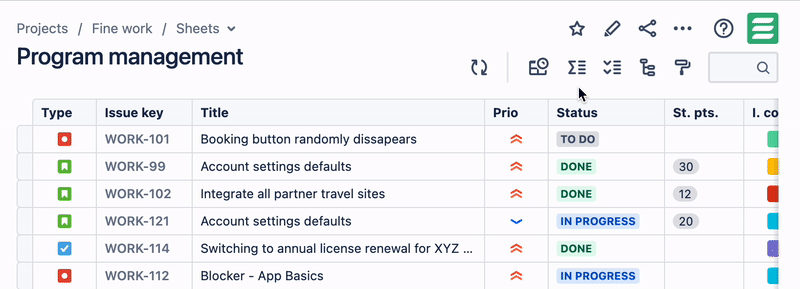

I understand you are looking for a solution in plain Jira, but just for future reference if a Marketplace should become an option for you: This should be easy to do using the app that my team and I are working on, JXL for Jira.
JXL is a full-fledged spreadsheet/table view for your issues that allows viewing, inline-editing, sorting, and filtering by all your issue fields, much like you’d do in e.g. Excel or Google Sheets. It also comes with a number of advanced features, including support for configurable sum-ups, either across all issues of your sheet, or across groups of issues if you use JXL's issue hierarchy or issue grouping capabilities.
This is how it looks in action:
As you can see, this view is fully interactive, meaning that you can work on your issues directly in JXL (but also trigger various operations in Jira, or export your data to CSV or Excel in just a click).
Any questions just let me know,
