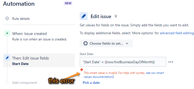

Hi @[deleted]
I also used the automation rule but I am getting the below error:-
I am using the "Start Date" Field instead of using the "First Business Day" Field.
I am also seeing Smart Values Documentation. but I am not getting the solution.
Matthew Olds
May 9, 2022
Have you tried dropping the, "Start Date" = at the beginning of your string? I would try just:
{{now.firstBusinessDayOfMonth}}
