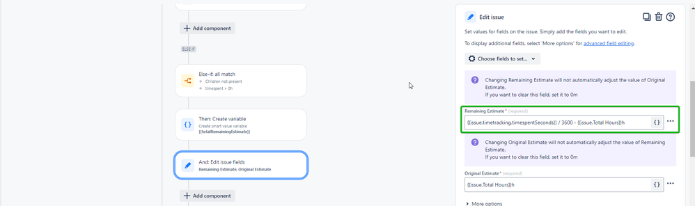

Hi,
I want to adjust the Remaining Estimate when the Total Hours field is updated. The Remaining Estimate will be.
Remaining Estimate = Total Time Spent in Hours - Total Hours
but the issue is if am using this smart value {{issue.timetracking.timespentSeconds}} / 3600 - {{issue.Total Hours}}h the rule is getting failed.
or if am using this smart value {{issue.timetracking.timespentSeconds.divide(3600)}} - {{issue.Total Hours}}h it is working but it is rounding up the value means if the value after division is 8.2 h it will show 8.00h.
The screenshot is attached as well can someone guide how can I calculate this?
Sebastian Boström
February 27, 2025
Hi Muhammad,
I'm not that great at smart values, but I think that I have an answer for this as I'm struggling with similar things. And I recon that you might already gotten an answer.
If you want to make a calculation with Smart Values you need to write it encapsulated with {{#=}} << Calculation >> {{/}}
