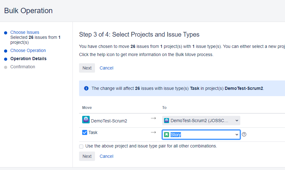

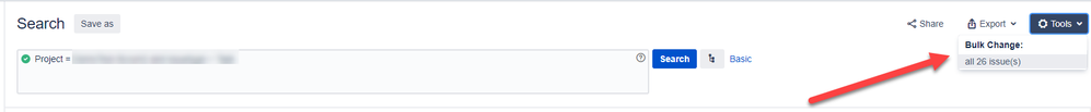

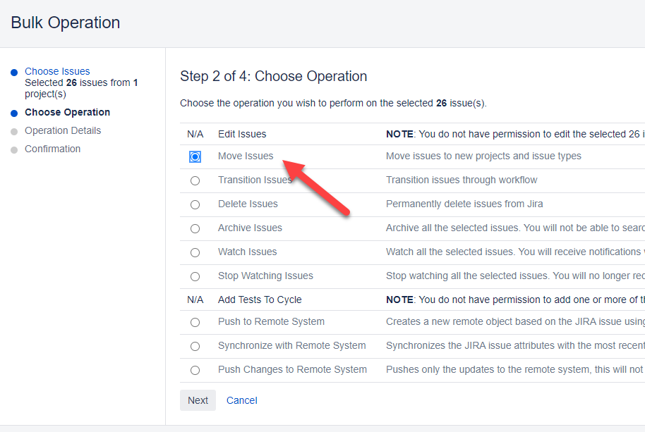

On the other hand, you can also achieve the same issue type switch by using the Bulk Change operation after you executed your JQL search in the Search UI without using a CSV file for yoru existing issues.  Inside the Bulk Change operation, you can select the Move Issues option and switch the issue type.  NOTE- This assume that your Task and Story issue types have the same set of fields.  Here are the images for your reference.

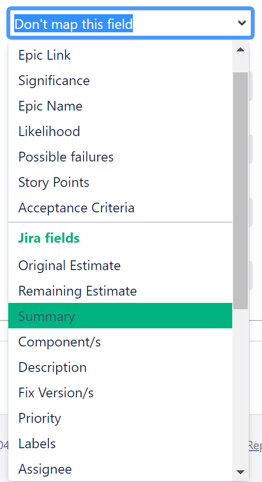

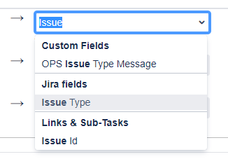

This was very helpful especially for the batch edit.     Last question, when I create the ISSUE TYPE in my CSV file, it does not provide a matching JIRA field or will it automatically populate correctly without a mapping?
Joseph Chung Yin
February 7, 2021
You will need to search for Issue Type.  All columns mappings against your CSV file are manual -
2021-02-07_16-17-06.pngBest, Joseph
