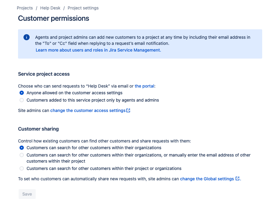

eliska.galambova
July 20, 2022
@Ronen Erlich can you post some screenshots?
I have the same problem but even this doesn't work.. I prepared user list which should be use as a list of managers who can approve absence...every employee can pick their manager but the problem is that no one but me (administrator) can see the list. Snímek obrazovky 2022-07-20 v 3.09.16 odp..png
