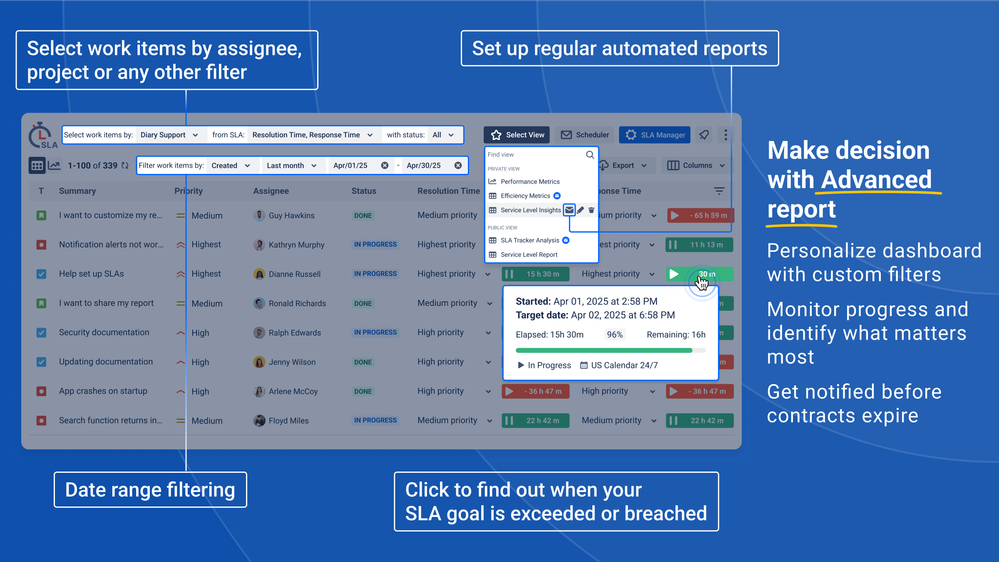

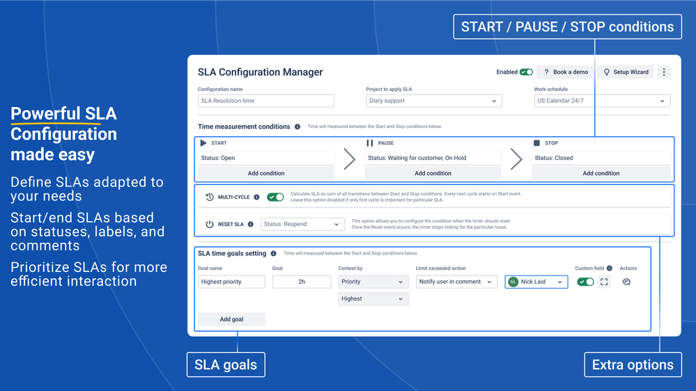

But if you’re open to using a Marketplace app, I highly recommend trying SLA Time and Report, developed by my team. It’s built to solve exactly these kinds of challenges, and is especially effective for support teams managing complex flows
With this app, you can:
✅ Create multiple SLA goals on the same work items, each with its start, pause, and stop conditions
✅ Start/stop SLA timers based on assignee, user groups, custom fields, or status
✅ View and compare SLA performance for each team in real-time
✅ Build clear reports and add visual SLA widgets to your Jira dashboard
It’s a more scalable option if you want to avoid breaking up your “In Progress” status into multiple stages or duplicating transitions.

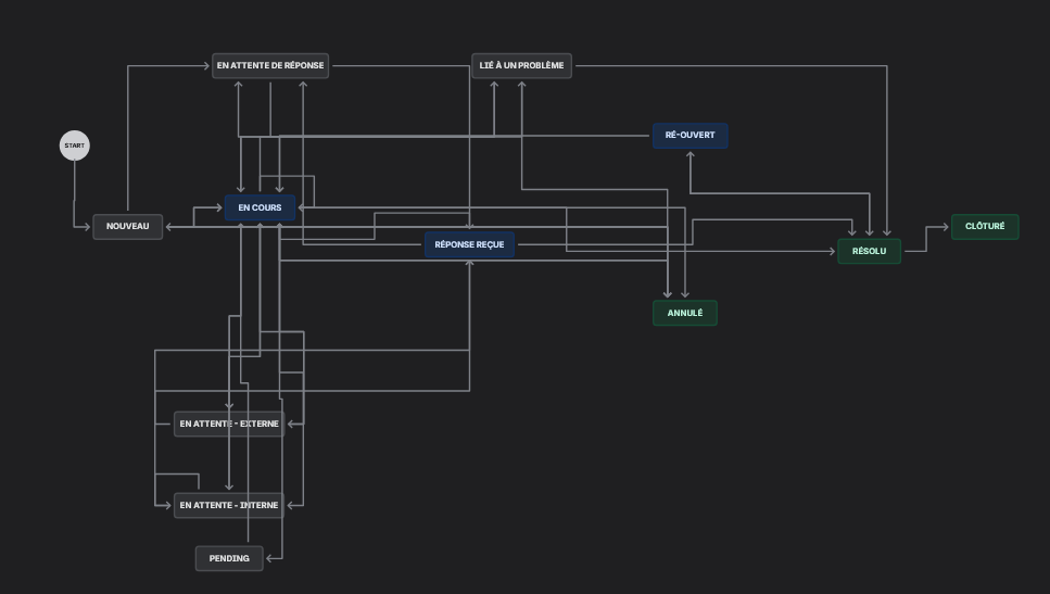

But I understand that i'll have to re-work my workflow to make this happen.
Didn't thought about this that way...but clearly it would solve everything (Except my Headhache)
I already got a request to make few update to it...so I'll do both after my Holiday .
This will need some duplication of transitions..
But having "En cours" (In progress) as "En cours N1 and "En cours N2" will make it
Thanks again to both of you ;-)
