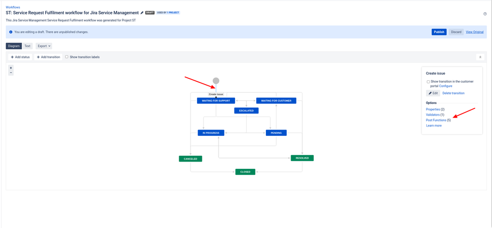

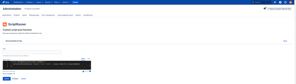

Below are a couple of screenshots of the Post-Function configuration.
1. In this example, the Create transition adds the Post-Function.

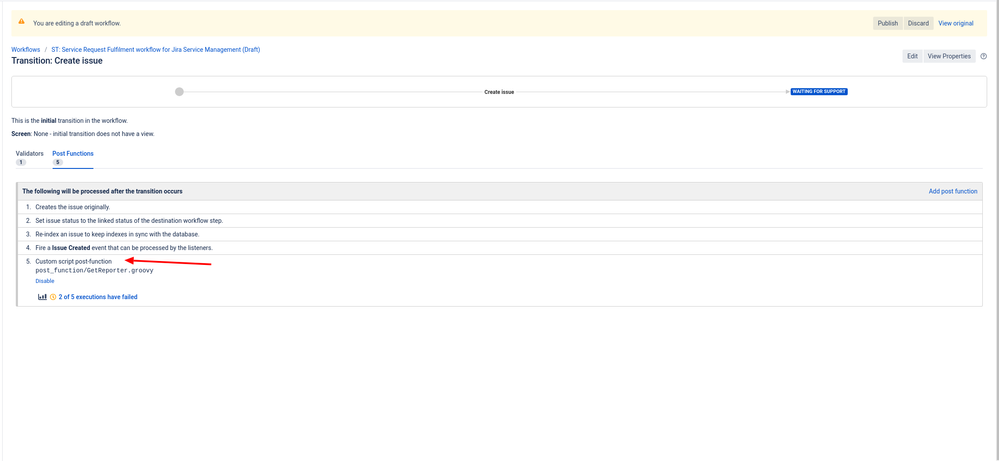

2. The Custom script Post-Function is used as shown in the screenshot below:-
3. The Custom script post-function view:-
Below are a couple of test screenshots for your reference:-

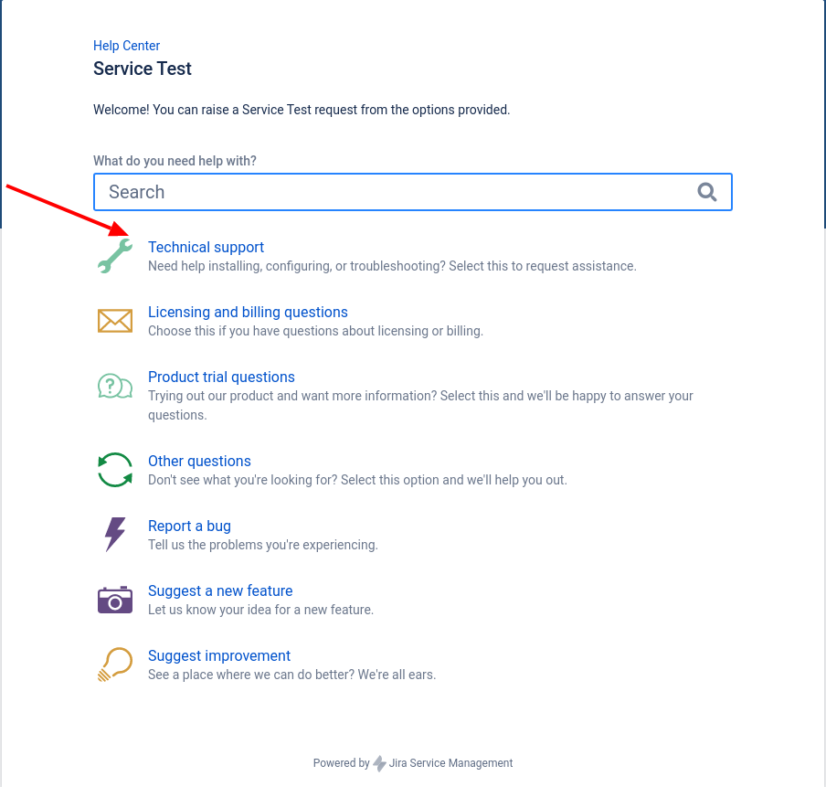

1. First, I am creating a Technical Support ticket.

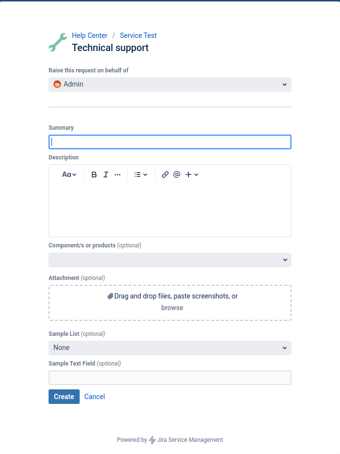

2. Currently, the Raise this request on behalf is set to the user I have logged in as

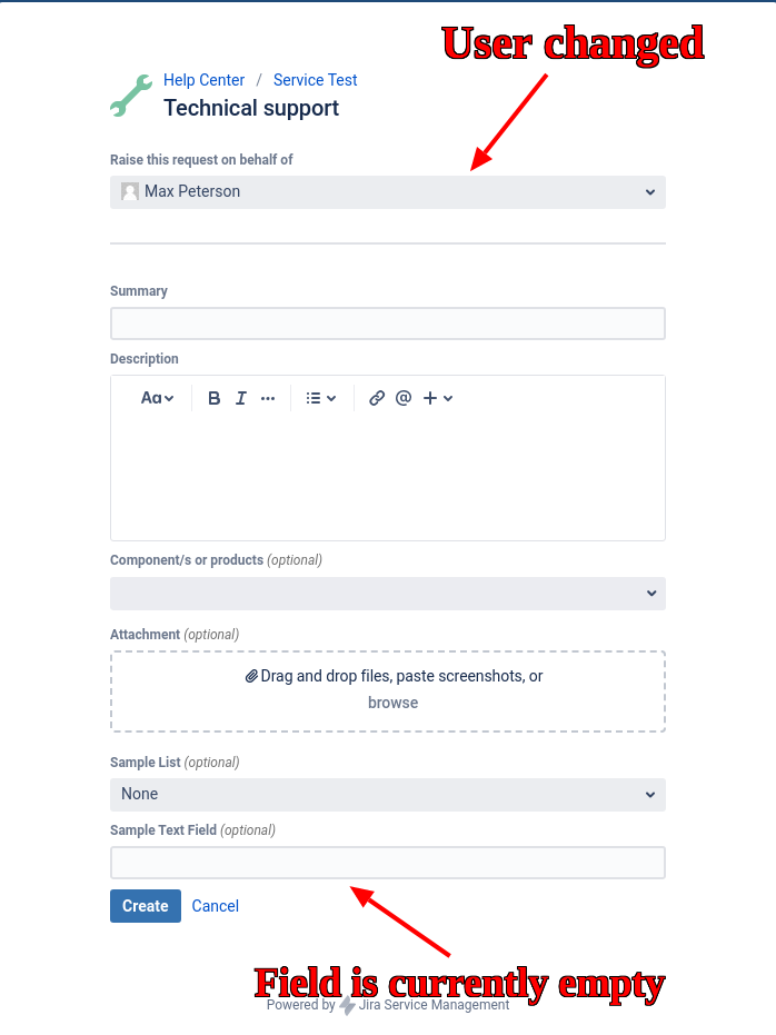

3. I updated the Raise this request on behalf of the field to Max Peterson and filled in the Summary and Description. Currently, the Sample Text Field is empty

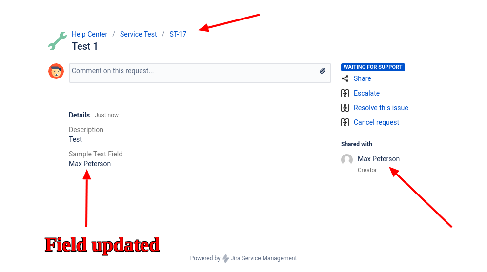

4. Once the ticket is created as expected, the Sample Text Field value is set to the reporter, i.e. Max Peterson and not the logged-in user.
