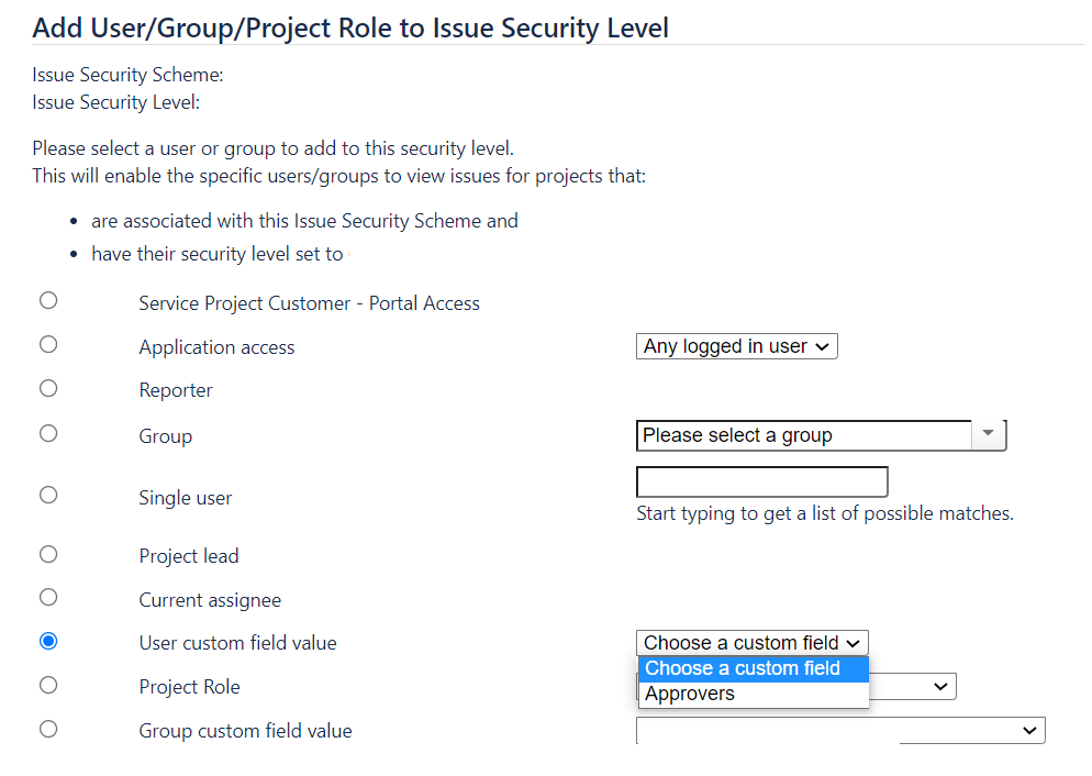

Moreover, since the "Issue Security Level" does not have any option where I can Add "Request Participants" as one of the "allowed" personas to view the Issue. See the attached image...

You can try to create custom field (people picker - multiple users field type), then add in automation to populate the field with the values found in the Requested Participants field.  Afterward, you can add the custom field to the Issue Security by selecting it from the "User custom field value" dropdown list.

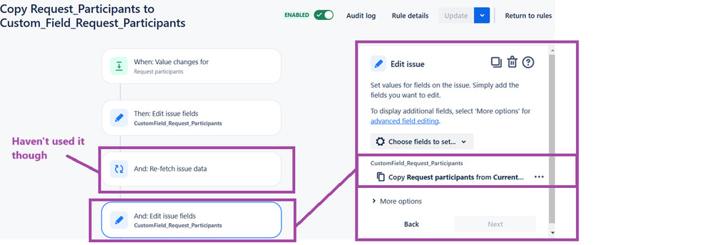

Ashraf B
February 7, 2025
Hi Noeli,
I have created Custom field "CustomField_Request_Participants" with "User picker (multiple users)" Type...
The automation triggers whenever there's any change (add / edit / delete) in "Request Participants" field and populates all the users in "Request Participants" field to "CustomField..."
Take a look at the attached image too...
Best regards,

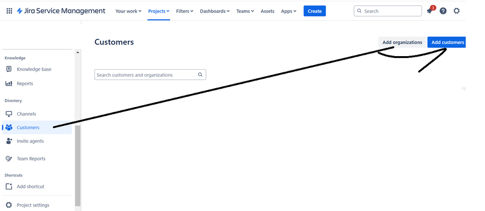

Ashraf B
February 7, 2025
Within Customers menu, there are two components - "Organizations", for instance, M/s. ABC Enterprises and within the "Organization", we have "Customers".20250208.png
I understand if the "Request participants" are listed within the said "Organizations", they would receive the notifications.
Please check this part...
