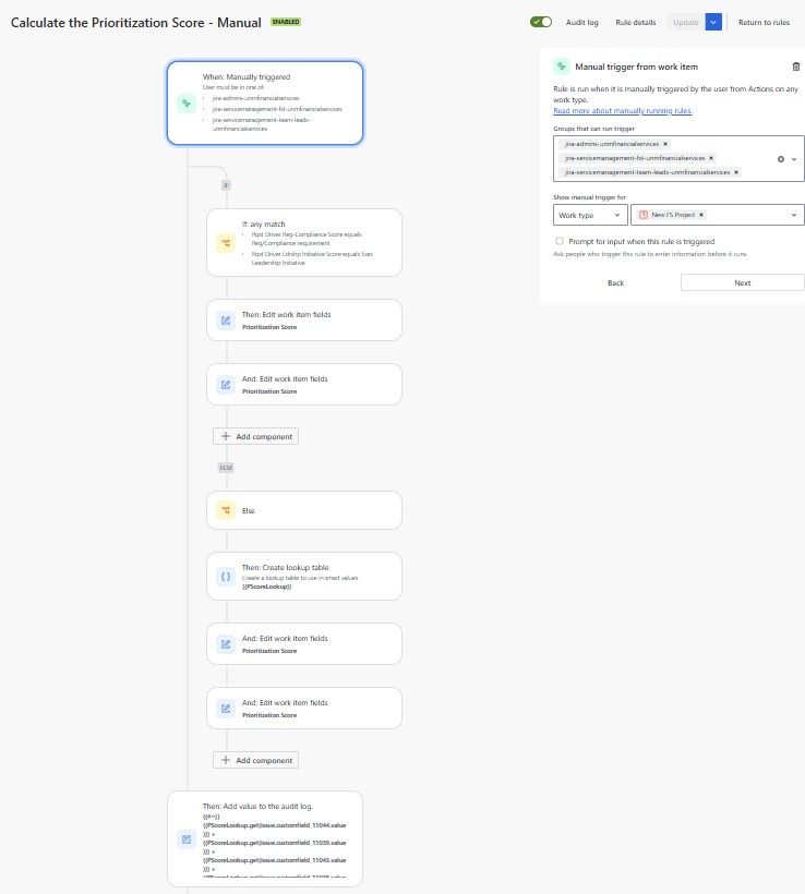

Hi, I need to calculate and display a score in a Jira Form based on multiple custom field values also completed in the form. All form fields are linked to Jira custom fields. I am using automation with a lookup to get the corresponding value of each field's drop-down selection, and math smart values to add those values for a sum (i.e., the overall score) and update the overall score field. I know the values aren't written to the Jira database until the form is saved or submitted, and I can't use the Form Submit trigger because the Customer needs that score to enter other data in the form. I want to display the overall score to help the Customer complete other fields on the form before submitting it, but I can't figure out a way to automate a Form Save or otherwise be able to calculate the form field values. Or is there another approach I can take to achieve this?
I'm using a company-managed project in JSM Standard cloud, here's my automation:

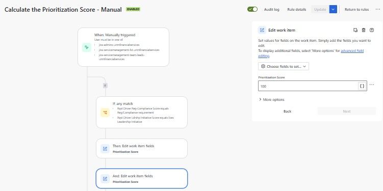

In this branch, if either of two drop-down selection options is selected, then the overall score is 100. The action above the one shown just clears the field if there's already a value in it.

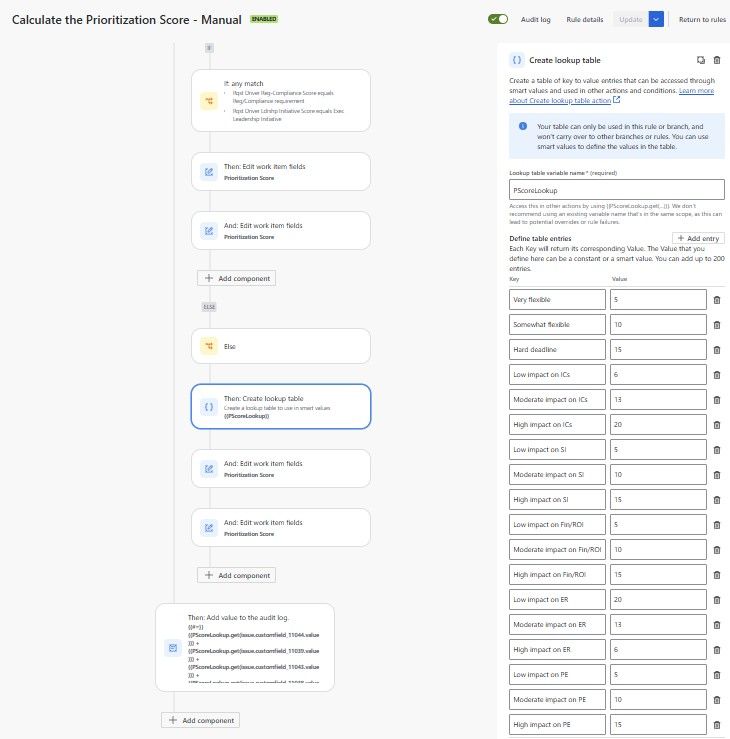

This is the selection list value lookup:

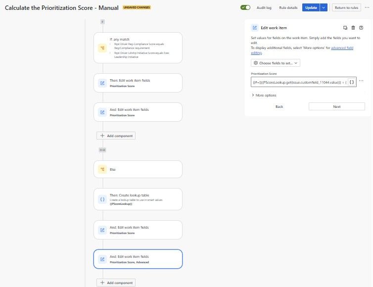

This is the calculation that adds the looked-up values for a sum (overall score):
The actual calculation "code" is:
{{#=}}{{PScoreLookup.get(issue.customfield_11044.value)}} + {{PScoreLookup.get(issue.customfield_11039.value)}} + {{PScoreLookup.get(issue.customfield_11043.value)}} + {{PScoreLookup.get(issue.customfield_11038.value)}} + {{PScoreLookup.get(issue.customfield_11071.value)}} + {{PScoreLookup.get(issue.customfield_11041.value)}} + 0 {{/}}
The first branch works if I manually Save the form (not Submit), the score of 100 is displayed. The second branch does not work -- nothing is displayed.

I just realized you probably need to know what the lookup is doing (sorry):
Regulatory or Compliance Requirement
Not a Reg/Compliance Rqmt
Reg/Compliance Rqmt
0
100
Executive Leadership Initiative
Not an Exec Leadership Initiative
0
100
Timing/Project Completion
Very flexible
Somewhat flexible
Hard deadline
5
10
15
Internal Controls
Improved data quality, security, reporting, etc.
Low impact on ICs
Moderate impact on ICs
High impact on ICs
6
13
20
System Integrity
Low impact on SI
Moderate impact on SI
High impact on SI
5
10
15
Financial/ROI
Low impact on Fin/ROI
Moderate impact on Fin/ROI
High impact on Fin/ROI
5
10
15
External Resources
Low impact on ER
Moderate impact on ER
High impact on ER
20
13
6
Process Efficiencies
Low impact on PE
Moderate impact on PE
High impact on PE
5
10
15
Driver
Options
Weight
So for instance, if the Customer indicates the Timeline for the request is "Somewhat flexible" (10 points), the application developed by the request will have "Low impact on ICs" (Internal Controls, 6 points), and all other drivers are the minimum impact, then the score would be 10+6+5+5+20+5 = 51 out of 86 possible points. (Either of the first two drivers being 'true' will automatically assign an overalls score of 100 because they have to be done and are highest priority.)

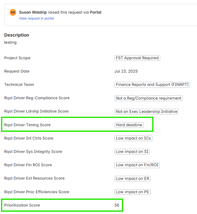

I wanted to follow up with a work-around for this -- not ideal but it does work.
I ended up moving all the selection fields and Prioritization (overall) Score field from the Jira Form to the Agent screen itself and (for the short-term) running the automation when they change a selection. I also kept defaults for all the fields to minimize the number of changes, since this will run up our automation count. That way, when the Customer changes a selection, the value is immediately stored and the calculation for the Score auto-updates.
Additionally, I have these same fields in a table on a different Form to enable management to make changes if needed and it works fine there. I guess it was just getting the values written to the Jira database first.
