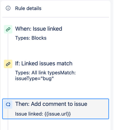

I think you can achieve what you want with thisScreenshot 2023-04-24 at 19.51.35.png
Change the Types and issueType to what you need. Also, play around with {{issue.url}} and {{destinationIssue.url}} to get the result that you want.

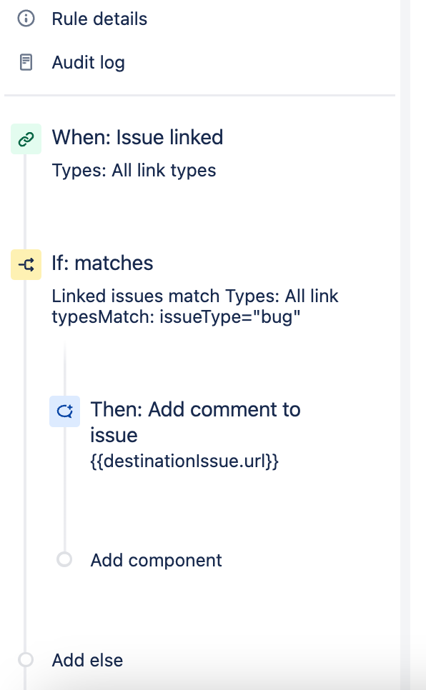

Was only able to put it in an if block which did post linked Bug to SR ticket.
Tried with {{issue.url}} and {{destinationIssue.url}}.
Looking to add this automation as Portal Users can't see linked tickets but do have access to non-service desk projects so would be able to follow the bug to resolution if provided the link.
Any further suggestions as to why my setup is not working please? 🙏
