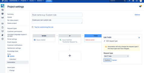

I understand that you're using Jira Service Desk Server and want to be able to automatically change the Customer Request Type field based on some criteria of the initial request.  If you're not familiar with the difference between a request and an issue, please check out Jira Service Desk: Issues vs. Requests.
In this case, the limitation here is not in regards to the workflows in place, but rather the automation here is limited in that it can only change the Customer Request Type IF the two request types share the same issue type.  This limitation is noted when you setup this automation rule (see the yellow box in this screenshot).
If the customer requests have different issue types, automation in Jira Service Desk is not currently able to change the issue type, hence it then cannot set the request type (since requests are a layer built upon specific issue types).  The main reason for this is that Jira does not currently have a REST API to move issues.  That is essentially what has to happen in order to change the issue type here.
There have been some other users in Community that have looked upon other plugins such as scriptrunner for a solution here, such as https://community.atlassian.com/t5/Marketplace-Apps-Integrations/Script-Runner-set-Field-quot-Customer-Request-type-quot/qaq-p/44063 However, it seems that other users have had difficulty setting up such a work-around.
Yes you could manually move the issue to a new issue type first, and then set the customer request type.  That seems like a fine work-around if you don't have to repeat these steps frequently.  However if you envision that this kind of move would be common, then I would suggest adjusting your multiple customer request types to use a single issue type.  This way, you can then rely upon an automation rule to adjust these requests for you instead.
