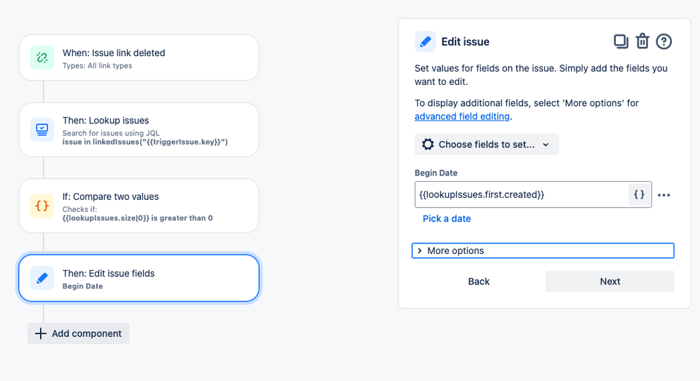

What value would I put in the for issue key? The smart value isnt working.
Trudy P Claspill
August 28, 2024
Please provide a screen image showing your complete rule. I can't tell you why it isn't working without that information.
This is an example of such a rule.
HOWEVER links are considered directional. When you remove a link two issues are affected. This rule will not necessarily be triggered by the issue you are viewing when you remove the link. It will be triggered by the issue that is considered the "source" in the link relationship.

Its all good I used the lookupissues action and ordered them to have the oldest ticket first. I then clear the field that was storing the date of the oldest linked ticket, then input the created date of whatever the now oldest ticket is. Which then kicks off my calculations. So it now works for linking and unlinking.
