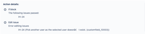

I have an automation designed to add a specific approver based on what the requestor selects from a dropdown list. However, its failing with this error:
I think the Actor can't read from the users DB, but I'm not sure how to give it the correct permission.

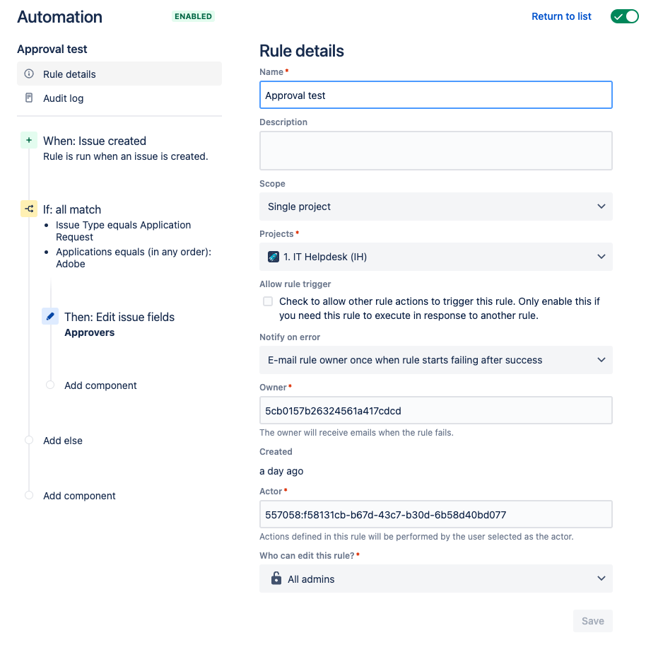

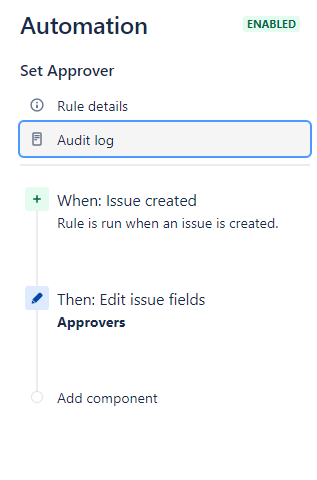

@Joseph Chung Yin Where would I go to validate this? This is what I see in the Rule details screen, hence why I thought this was related to the actor:

From your previous audit log entry, it is pointing to the value that you selected for the field doesn't exist.  Thus, it has nothing to do with the actor for the rule.

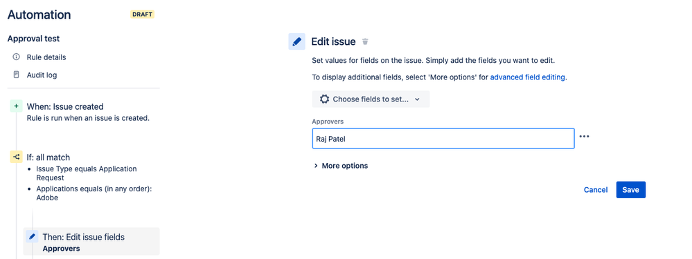

I've tried several users in that field including myself. I did notice something odd though: that field does not let me choose from a list or even appear to search the users db. All I can do is type a name in and hit save.

Yes if I use my own name in the rule config it still fails with the same error. As mentioned above, the Approvers field in the rule config, doesn't allow me to select a user from a list, nor does it do a lookup when I start to type in name I know is in the user db.

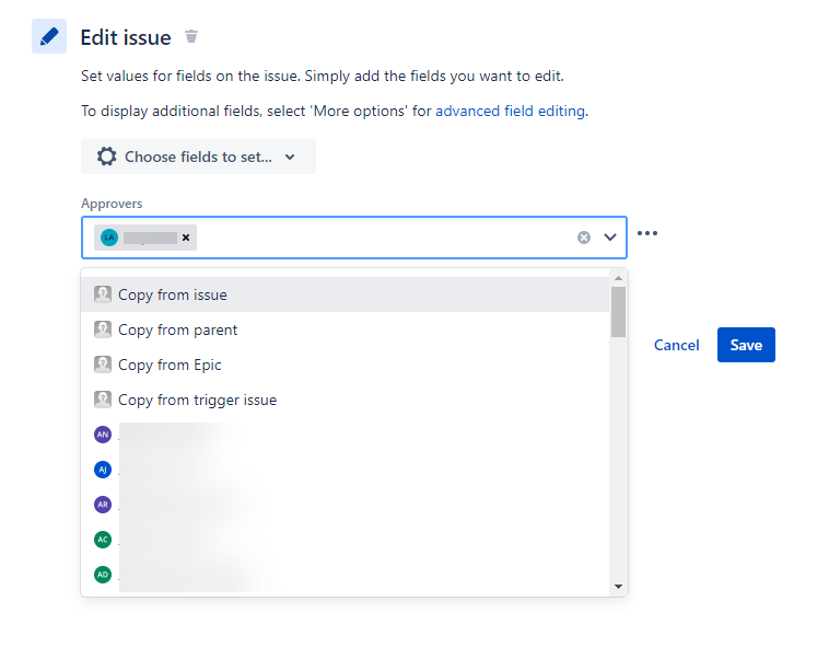

Very odd.  Did you see an empty dropdown list in the Approver field in the rule action configuration?  In my end, I see a list of users...
Here is my sample test rule -

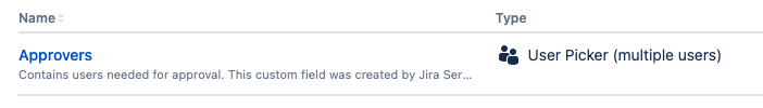

No dropdown at all, it's behaving like a short text field, even though its configured as a user picker.

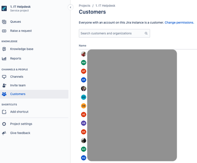

I don't believe this to be a Google sync issue. This is what I referring to:
So the project lists everyone in my org (from Google) when I go to this Customers screen. That's why I thought this might be an actor permissions issue, especially given the behaviour of the Approver field in the rule config.

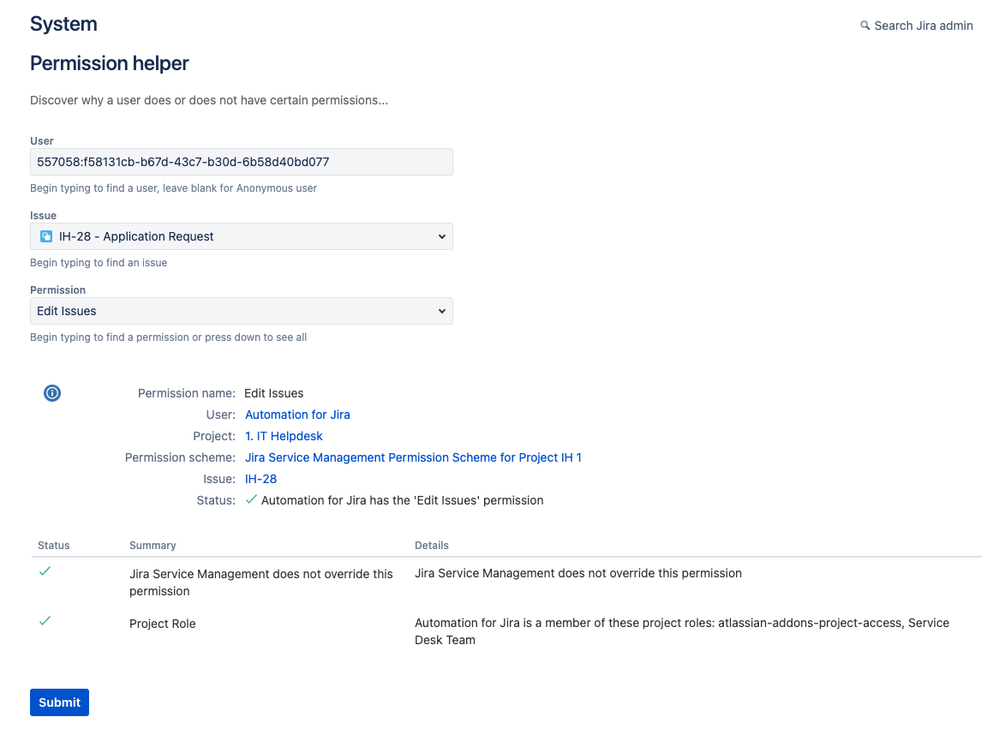

Did some more digging: the Actor listed in the rule doesn't have a name its just string of characters and I can't search for them anywhere (eg the Customers view above). However, if I go to Permissions Helper I get this:
So the actor is actually called Automation for Jira (which makes sense I guess), and according to the helper, should be able to execute my rule. Not sure where to go from here...
