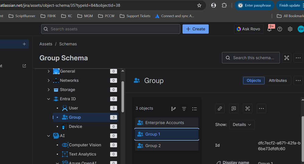

I have an Assets object. It's id in Jira is 38 (as seen in the URL), and it has an "Id" attribute from Azure AD (in the lower right).
How do I get the Id attribute in Automation rule? {{issue.customfield_10582."Id"}} gives me 38.

I use a plugin called Azure Sync for Jira Assets to perform scheduled sync, and it does not allow editing the mappings. Id in Azure will always be Id in Assets.
I tried using {{issue.customfield_10582.attributes}} and that when using Log Action gives me this:
[dfc7ecf2-a671-42fa-ba23-6be73dfdfc60, Group 1, GS-38, 14/Oct/25 4:37 AM, 14/Oct/25 4:37 AM]
That is an array with a single element, the commas are actually data, proven by {{issue.customfield_10582.attributes.first()}}
But if I tried to further process it with {{issue.customfield_10582.attributes.first().split(",")}}, I get an empty string.

That worked, the actual object type from .first() is unclear, storing in a variable forces it to become a string.
3 votes
KC Wong
October 23, 2025
Printing {{issue.customfield_10582.attributes}} gives me:
But there has to be a better way then to depend on the attribute order.
That turns out to be a single element array. The commas aren't delimiting the elements, they are the content.
So calling .get(0) on that is useless.
