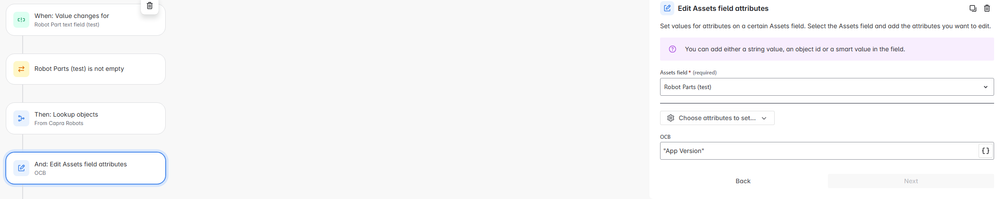

Frederik Vodsgaard
July 11, 2025
I tried this as this seem like the closest i could get to something that makes sense:
If i have an object called OCB with an attribute "app version" can i then do it this way?
(EDIT: i am still a bit confused about how i this works exactly )
Marc -Devoteam-
July 11, 2025
Hi @Frederik Vodsgaard
Yes you could
