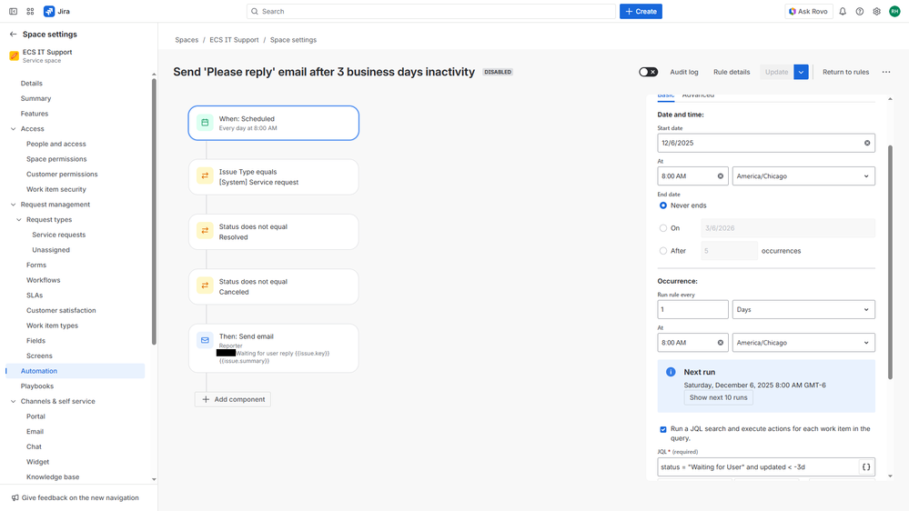

We are trying to setup an automation rule to send out an email at 8:00am to users if their ticket has sat with the status of "Waiting for User" for 3 business days with no activity. So, currently with the way we have it setup, the rule is running but not performing any actions even though when I validate the rule it doesn't state that no tickets currently match.
I also have another concern that the rule is going by calendar days instead of business days and so these emails will be sent out over the weekend.
Also I want this rule to trigger once at the [3-5) day mark. So when it runs at 8:00am, any ticket that is over 3 days inactive and under 5 days inactive will get an email sent (unless there is a better trigger for this rule).
This is what I currently have setup for an automation rule:
3 answers
6 votes
Bill Sheboy
December 5, 2025
Hi @Ryan Hormann
Short answer: There is no built-in JQL feature to allow comparing business days, only calendar days.  Thus, an alternative is to use two rules: one saves the date / time in a custom field when a work item transitions to "Waiting for User", and a scheduled trigger rule which can use the date / time diff() function for a business days comparison.  And, there are also some problems with the rule you show, so please see below for those.
For the rule you show, it uses a scheduled trigger with JQL, and by default, this option is enabled: Only include work items that have changed since the last time this rule executed.  That means the rule will not repeatedly check items which have already been processed.  But, that may not work for your scenario because the rule will use date / time functions and not JQL to check for the elapsed business days.
Next, your trigger JQL checks for status = "Waiting for User", but then the rule later has conditions which always pass: the checks on status of Resolved and Cancelled.  Are you checking what you wanted with those, or did you instead want to check the Resolution field?
Finally, you likely only want to send the reminder once (or a limited) number of times.  Please consider how you want to track that in the work item to prevent repeated reminders to the person.

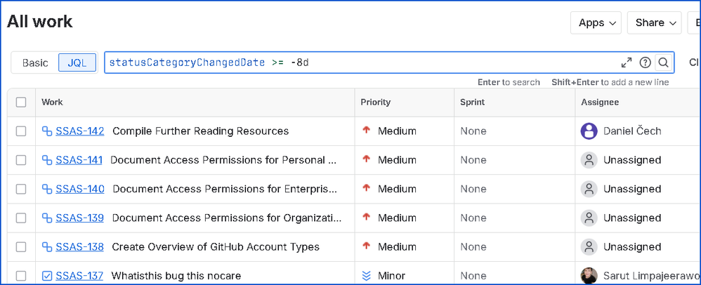

I did a quick test and there is something called "StatusCategoryChangeDate" (That I honestly did not know about nor have I used before).  Screenshot below.  If Ryan wants to know for certain the number of days since the Stauts Was Set, then he could attach that status to a unique category and use this date check.  And, three filters would still be the work around for cacluating workdays..
As you said,  lets confirm the final "need".

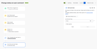

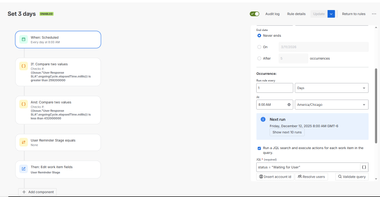

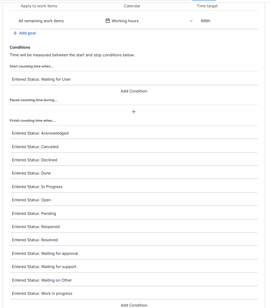

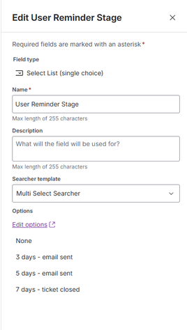

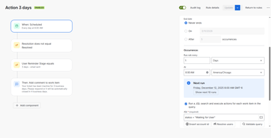

Hello! I wanted to give you two an update on this setup. I read through both replies and since I'm still somewhat new to Jira I actually went to ChatGPT for a little help (which helped me understand Bill's solution better)
I ended up making an SLA timer, a custom field, and 6 rules, which is the solution that ChatGPT helped me with.
The SLA timer has a goal timer of 999h and is set to start when a request enters "Waiting for User" and stops when a request enters any other status. The SLA timer also goes off of working hours. The custom field is a single select with 4 options: None, 3 days, 5 days, 7 days. None is the default option. The first 3 rules, scheduled at 7:30am, are setup to set the custom field based on the elapsed time in the SLA timer. The last 3 rules, scheduled at 8:00am, are set to add a comment based on the custom field value (instead of an email, since comments already send an email). I also have one other rule where if a ticket is in "Waiting for User" and a user comments, it changes to "Waiting for Support", so on this rule I put "then change custom field to None" at the end to reset this value.
I would appreciate any feedback on this setup as the logic might be off and it may be more complicated than need be.
Here is what I currently have setup:

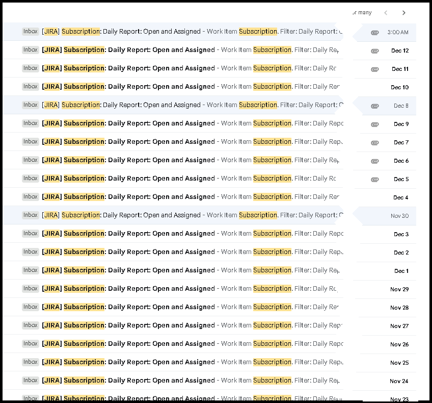

Dave's Pizza Challenge

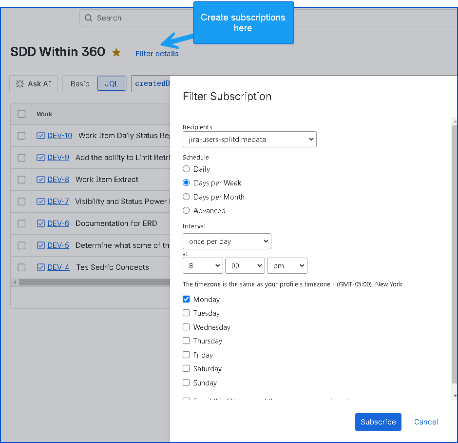

Hello again.  @Ryan Hormann .  I'm an old man and it really is okay to laugh at my "get off my lawn" attitude on this one.  :-) .  So no hard feelings either way.  But:
1. see the screenshot below.  I set one of these up weeks ago to show someone else and it runs everyday. You can use this approach on ANY or even all of you existing filters.
2. I challenge (dare) you to ask ChatGPT if you can accomplish your use case with the filters and subscriptions as I've proposed.
Here is the challenge reward. (I used to do this all the time back when I was actually in a corporate office).   If you can provide a chatGPT repsonse that definitively says the filter subscription and creative date setting CAN'T WORK, I will send you and your team up to ten pizzas next week to whatever location you choose.  Hopefully that's your office but it can go to your favorite charity if you prefenr.
Now if you simply hate the filter concept for whatever reason, thats obviously okay.  But it will work so if you are hoping to get this done, I swear it won't take you an hour to set up and you'll have this working by Monday 8:00 AM (your next run time).

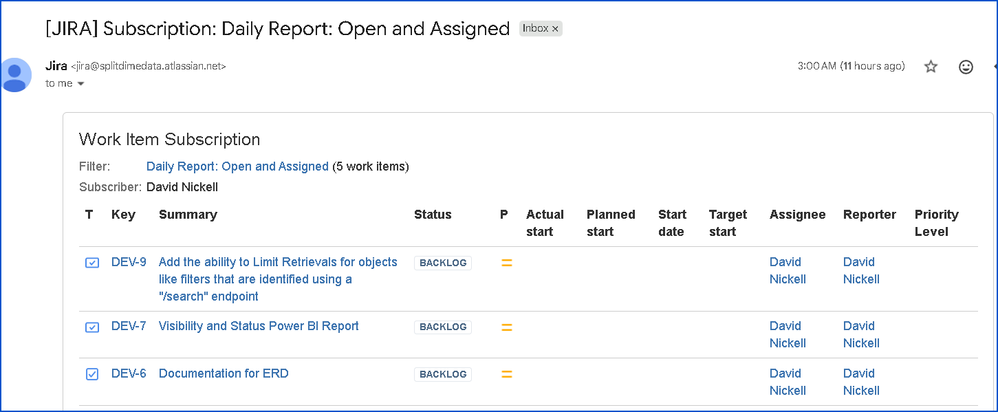

Hello. how to do automated emails comes up on a regular basis and my go to answer (for 15+ years) has been to use a filter subscription.
You can find documentaion on Subscriptions here:  https://support.atlassian.com/jira-software-cloud/docs/manage-filters/#Create-an-email-subscription-for-a-filter
Your situation has two unique points:
1. You want to run only M-F at 8:00 AM
2. You only want this to be concerned with Business Days
With this solution, you will need three Filters and Subscriptions.
Each JQL would include
Status = "zzzzzzz" and Assignee = CurrUser().
And the check for lastupdated:
  • Monday =  lastUpdated <= -5d
  • Tuesday = lastUpdated <= -4d
  • Wed,Thu,Fri =  lastUpdated <= -3d
Then run the correct JQL Subscription on the correct day of the week:
Here is what the email looks like (I get one each day at 3:00 AM).
